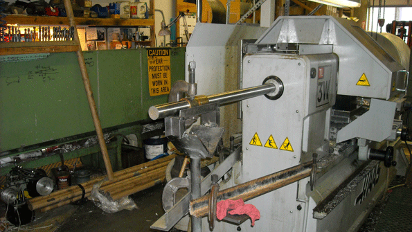

On January 29, 2010, a 27-year-old machinist was fatally injured when he was struck by a piece of round stainless steel bar stock that he was machining in a computer numerical control (CNC) lathe. A coworker explained that the victim was machining washers for a gill net reel frame from the round bar stock. The machinist had placed a 6-foot piece of round bar stock into a Haas TL-3W model lathe. Approximately three feet of unsupported bar stock extended past the spindle.
As the victim monitored the lathe operation, the unsupported portion of the bar protruding through the spindle bent to an 80-degree angle.
The shop general manager speculated that the victim heard the noise generated by the rapidly rotating round bar stock, and went to inspect it. As he stepped to the back of the machine to inspect the source of the noise, the manager further surmised, the machinist was struck by the bent piece of bar stock. The coworker and a contractor heard a crash sound in the vicinity of the lathe and, upon responding, found the victim unconscious.
What went wrong — The circumstances are simple to imagine, but there are series of errors in this situation that should be understood, and avoided.
1)  The three-feet length of bar stock extending out past the spindle of lathe was unsupported.
2)  There was no system in place to support the length of bar stock extended past the spindle.
3)  There was no formal safety plan that addresses hazards regarding operation of lathe with bar stock extending beyond the spindle.

Following the incident described above, the employer manufactured a system to support bar stock that extends past the spindle. If this support system had been in place, the incident may have been prevented.
Employers that manufacture their own support system should work with engineers or companies who specialize in creating these support systems to ensure that the system is feasible and safe. Other methods to help abate this hazard include machine barriers to prevent workers from entering the path of a potential hazard; working with shorter lengths of stock; and cutting stock after material is delivered, so it will not extend past the spindle.
