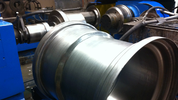

Aero Race Wheels uses spin forming on lathes to produce its wheels. The process involves rotating a cylindrical steel workpiece and a forming tool at high speed while exerting localized pressure using a roller, causing the metal to flow over the tool. The technique is ideal for manufacturing axially symmetric parts, such as wheel rims, and it creates a very strong, seamless component from a single piece of material, with little or no scrap.
The shape forming operations are performed on a 20-year-old Autospin metal spinning lathe. This machine has two sets of pressure rollers – one at the front of the workpiece, the other at its rear – which means that both sides of the wheel rims are formed without manual intervention. Each set of rollers has two motion control axes, X and Z, driven by four hydraulic cylinders, plus the motor-driven lathe spindle.

To improve this situation, Aero found a machine rebuilder that specializes in machine upgrades for spinning lathes. The rebuilder performed a comprehensive mechanical and electrical rebuild of the lathe. But, for the critical CNC element of the refurbishment, it chose to retrofit a high-end solution from NUM, primarily because an application-specific software developed by NUM’s U.S. subsidiary helped to overcome all limitations of the lathe’s existing control system.

“Our business demands very flexible manufacturing – we manufacture mainly in small quantities and we need to switch between batches as quickly as possible, as well as being able to trial new designs,” according to Marv Dailey, design/process engineer at Aero Race Wheels. “The service provided by NUM and our machine rebuilder partner has been exemplary, giving us a combination of precision mechanics and state-of-the-art metal spinning programming and control. Product changeover typically now takes less than 20 minutes, and the semi-automated method of generating and optimizing spin cycle programs has significantly reduced development and operator training times. Offline programming also frees up time on this critical production machine, further boosting productivity.”
