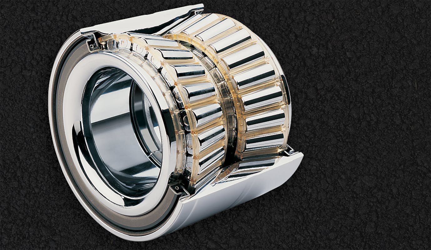

The most common spindle TRB configuration is the 2TS-IM (two opposing single row TS or flanged TSF single row bearings, indirectly mounted), as shown in Figure 13. This design allows easy machining of adjacent parts and is easy to assemble.
The distance between the bearing centers should be 2.5 to 3.0 times the spindle nose bearing bore, which helps to achieve thermal equilibrium during operation and optimizes the moment spindle stiffness for overhung tool loads.
