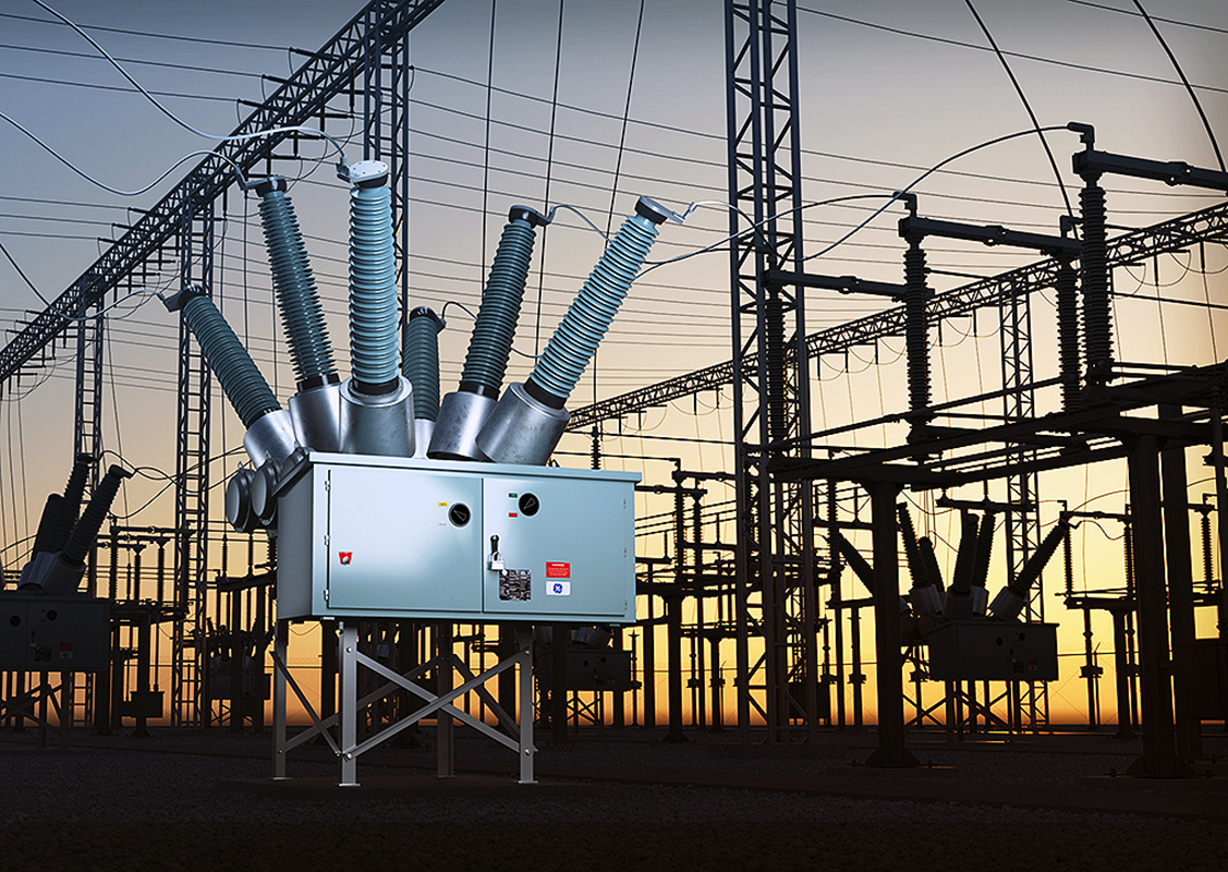

The first award, for $2.3 million to GE Renewable Energy’s Grid Solutions business, is related to development of a sulfur hexafluoride (SF6)-free 245-kilovolt (kV) dead tank circuit-breaker – a protective device used in case of a problem on the high-voltage electrical network (“the grid”) to cut or redirect power, to avoid blackouts.
The new dead tank circuit-breaker will be built at a GE site in Charleroi, Penn., drawing on work conducted there and at GE’s technology research center in Villeurbanne, France.
The new circuit-breaker will use GE’s g3 (“g cubed”) gas insulating and switching technology, which according to the developer has a global warming potential that is 99% less than SF62 (an insulating and arc-quenching atmosphere) when used as a circuit-breaker. As g3 products have the same dimensions as SF6 equipment, there is no increase in emissions during the manufacturing process from additional material.
