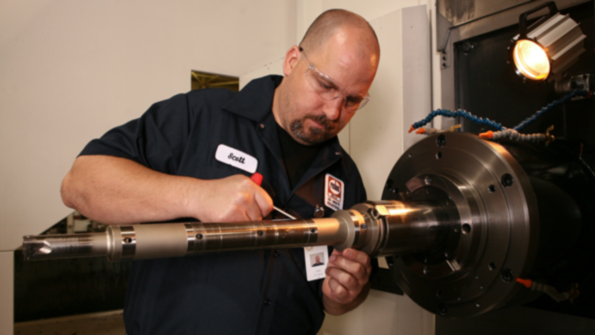

A Redoe Mold Ltd operator assembles the Ingersoll InnoFit longreach tool to mill the bottom of a deep mold cavity For extra rigidity the coupling offers threepoint contact a selfcentering design and a large contact area at the mating surfaces

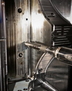

Chicago Mold Engineering found a faster way to mill deep cavities and cores in hardened steel molds. Here, a new Ingersoll Hi-FeedMini mill semi-roughs a mold cavity twice as fast as before. On high-hard P20 mold steel, the 1.25-inch tool feeds at 199 IPM.
That’s the bad news. The good news is that, with high-feed machining practices and leading-edge tooling, alert mold shops are overcoming these obstacles and improving their competitive positions. “Long-reach machining, indispensible for deep cavities, is all about increasing rigidity and reducing lateral cutting forces,” said Bill Fiorenza, die and mold product manager at Ingersoll Cutting Tools.
Following that strategy, Chicago Mold Engineering, St. Charles, Ill., now completes the semi-roughing of extremely deep cavities in high-hard, P20 steel in half the time as before. An Ingersoll Hi-FeedMini cutter feeds at 200 IPM, versus 80 IPM before. A cavity that once took six hours is now done in two and a half.

For the 22-inch cavities, Redoe always uses a brand-new new Toshiba boring mill, the extra-rigid Ingersoll Inno-Fit shank extension and the high feed Form-Master V cutter with premium inserts. With that package, Redoe routinely holds 0.001 in. tolerances on both dimension and runout all the way to the bottom. High-feed, positive-rake geometry of the insert converts most of the lateral forces to axial forces, helping to keep the cutter on center all the way down.
An important design detail that promotes the shank’s rigidity is a self-centering 3-point coupling design, large surface contact area at the mating surfaces and an extremely wear resistant material of construction. By contrast, many conventional shank extensions use a slide coupling system between butting surfaces.
