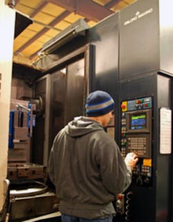

Setting up another high-feed milling job at Wemco. The practice has helped the machine shop improve its accuracy and productivity on more complex orders, allowing it to become profitable with contract milling orders. On average, Ingersoll high-feed milling tools have tripled removal rates and doubled tool life.

“At the manufacturing end, our key to success has been to embrace leading-edge machining practices, mostly high-feed milling, and to keep pushing it,” according to Juston Rouse, manufacturing vice president. “We’ve reduced our plant-wide milling costs by half as a result, and can deliver a contract job within three weeks on average. We can win a lot of jobs with that capability — and still hold good margins.”
In this effort most of the tooling Wemco has selected is from the Ingersoll Hi-Feed series, which feeds faster but takes lighter cuts that lead to higher material removal rates (MRR) with less wear and tear on the machines. The typical parameters for mild steel are 240 IPM at 0.050 in. DOC, versus 80 IPM at 0.070-0.120 in.
“The math is clear,” Rouse said. “Tripling the feed while reducing DOC by maybe half means we’re doubling the MRR, at least.”
