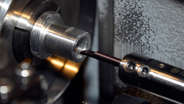

Medfab Manufacturing improved its boring of small diameter medical parts dramatically with new Ingersoll TMicro microboring tool The operation shown here is a threequarterinch hole in tantalum Even on bores down to 0243 inches in thinwall titanium tubing the tool produces asmachined surfaces of 810micro lasts up to 10 times longer than previous tooling at 16 faster machining rates

If the experience at Medfab Manufacturing is any indicator, long-reach boring in tiny parts needn’t be the problem it once was. That Lakeville, Minn., shop described its challenge as a machining “perfect storm”: ID machining, thin walls in titanium, 4:1 aspect ratios and a 16µ surface finish spec.  The workpiece is a 1-inch long x 0.25-inch diameter piece of titanium tubing, with walls thinner than your fingernail.
The remedy is a very advanced boring bar with a novel elliptical cross section, through-the-insert coolant delivery and high-feedtip geometry.  It is called the Ingersoll T-Micro boring bar.  The long axis, aligned with the cutting tip, provides additional rigidity and vibration control.  The short axis expands the channels for chip disposal.
Cycle time with all previous boring bars was 3.5 minutes – followed by 15 minutes of hand polishing on every single piece to reach the 20µ ID finish spec.  With the T-Micro boring bar, cycle time was reduced to 3 minutes, as-machined surface came in at 8-10µ (even on the 250th piece), and all hand finishing was eliminated.
Based on that success, Medfab now uses the T-Micro cutter on tantalum, MM35P (machinability like Waspalloy), and other high-nickel alloys.
