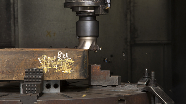

In mid-2014, to free its new 50-HP Mazak for more high-precision work, Cyber bought a 30- year-old Kingsbury with a 25HP, specifically to continue the valve gate job, and tooled it with the same ISO-Plus used on the Mazak. The job ran well enough on the Mazak despite the cutter’s 0.040-in. depth limitation, which required multiple passes even to get through the oxide crust down to bare metal. But, on the looser Kingsbury, cutting edges didn’t last a single pass.
New facemill for vintage machine — Ingersoll field rep Mike Salewsky sized up the problem right away. “Those oxides eat carbide cutting edges for lunch. We have to get through the oxide with the initial pass, regardless of its depth, without overloading the spindle.”
A partially machines valve gate at Cyber Manufacturing in Houston. An Ingersoll Hi-QuadXXX facemill cuts right through the oxide crust on the first pass, accelerating the operation and improving edge life significantly.
Accordingly he recommended a 3-inch Hi-QuadXXX mill, a high-feed mill with 13-mm inserts able to take off up to 0.250 in. per pass. “The part geometry called for a larger cutter able to go deeper, but the old Kingsbury’s weary bones and horsepower limitation suggested starting small,” said Salewsky.
Assisted by Tam Nyghen of local distributor United Tool and Supply, Mike got the tool to Cyber overnight and came in the next day to set it up and go operational. After a couple of trial passes on the actual part, they arrived at 756 rpm, 75 IPM, 0.200-in. DOC as the optimal parameters. At those settings, the removal rate more than doubled, versus the earlier ISO-Plus. Cutting edges lasted through an entire part, including both sides and 4-6 complete passes.
Even at these settings, the 25 HP spindle showed no signs of overload. Spindle loads stayed well under 60%. And, despite the machine’s loose frame, the operation ran very quietly with no hint of hammering or chatter. “The process was stable, so it seemed worthwhile to go with a larger cutter able to cut even deeper and complete the part faster,” said Salewsky. “Moreover, the oxide skins on some of the forgings run 0.300 in. or more.”
More Cutting Depth... No Edge Loss
So, Mike brought in a 4-in.  Hi-QuadXXX with 19-mm inserts capable of 0.300-0.500 depth of cut. Working with programmer Ken Dinh, he fine-tuned the parameters to 477 rpm, 50 IPM, and 0.300-0.500-in. DOC, depending on the oxide thickness of the piece to be machined. At these settings, the removal rate doubled again, with no loss of edge life. Some edges lasted through more than one part, or 6-10 passes. “At these settings, particularly the depth of cut, the cutting edges encountered metal only and no oxide,” Salewsky reported.
