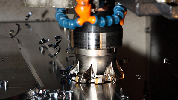

The new tool — an Ingersoll Gold-Quad F facemill — seemed an unlikely choice for Shaw’s applications. Introduced about two years ago, it is nominally a high-feed tool tailored for fast, shallow passes. Yet at Shaw it is excelling at depths of cut approaching 0.100 in. Other mold shops using the same tool are running this hi-feed facemill as deep as 0.075 in. Running 22/5, the 37-man mold and welding shop is accustomed to big work, including structural fabrications weighing up to 15 tons.

“We were moderately satisfied with our rough milling processes on hardened mold blocks,” Steve Knight recalled, “but we always felt there was a better way.” Their standard parameters with a 3-inch facemill had been 485 RPM (650 sfpm) 0.040 in. depth of cut, and 100 IPM. Whenever they pushed further, the inserts would shatter, and very often that triggered a cycle of reworking parts and repairing the cutters or fixturing.
It was the big mold order, with its tight schedule, that prompted Knight to look for a better way. Each of the 16 blocks measured 24x36x8 in., weighed about a ton, and required hogging out 600 lb of hardened P20 material to create the mold cavities. “Five tons of stock to remove in all, with not much time to do it,” Knight added.
He tried out one new cutter. It improved the removal rate slightly but the inserts wore out too soon and cost a lot more. So he asked Josh Jolley of Allegheny Tool and Supply for a better solution. Jolley brought in Dennis Hawke of Ingersoll to demo the Gold-Quad F. Based on experience, Hawke was confident that the new tool could increase throughput at least 25% and be just a drop-in replacement.
“Though primarily a high-feed tool, it has proven out in scores of deeper-cut applications, so we were confident it would work,” said Hawke.
In the trials, with Hawke’s and Jolley’s guidance, the parameters were ramped up gradually up to balance removal rates and edge life. In the end, the new cutter nearly doubled the removal rate with absolutely no insert fractures. Edges looked as good as new after several passes. The operation also ran more quietly. Check these results:
Given the delivery pressures for the mold blocks, Shaw immediately adopted these parameters as standard and monitored the process closely. Cycle times per block dropped from ten hours to six, which helped shave about a week off the delivery schedule. After three days’ experience with the new tool, Shaw operators made two observations: edge life was up 20% longer with no ruptures, and the spindle load was the same as before despite doubling the depth and feeding 20% faster.”

Inserts at Shaw need changing 20% less often with the Ingersoll Gold-Quad F facemill, and always because of gradual flank wear, never shattering. Note rugged cutter design, extra-thick inserts and sturdy center-screw clamping for handling heavy cuts. Free-cutting insert design and ‘slippery’ coating post treatment enabled a 67% increase in removal rate on hardened stock without raising the spindle load.

Though the removal rate was increased by two thirds when the Ingersoll Gold-Quad F facemill went into use, the spindle load didn’t rise at all. “Now that’s free cutting,” said Shaw foreman Steve Knight.
The Ingersoll Gold-Quad F facemill may seem an odd tooling choice for this deep-cut application. Classified as a high-feed tool, it is known better for quick, shallow cuts. Yet at Shaw, each pass removes a depth of 0.075 in. “That’s definitely beyond the ‘comfort zone’ for a typical high feed tool,” Hawke explained. “This is really an all-purpose tool.”
