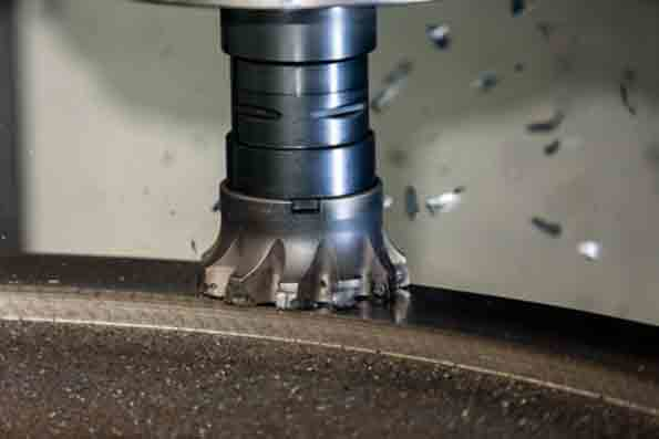

Ingersollrsquos Hi QuadF face mill works like a router to make more chips faster The tool rotates at 785 SFM as it feeds outward at 0561 IPR on the C axis Freecutting tool geometry with a 12deg lead angle minimizes lateral cutting forces for stable machining all the way out to the circumference of the flange

The main concern was to remove 0.200-0.400 in. of stock fast without overloading the auxiliary spindle, especially laterally.  In flange work, low lateral forces are essential to keeping the flanges perfectly flat, preventing leaks when the valves go into service.
Using “live turning” tooled with Ingersoll Hi QuadF face mill, DeZurik completes valve flanges in one-third the time of conventional ‘stick’ turning with a single point tool. A five-inch rotating tool brings eleven edges and two axes of rotation to the operation, speeding metal removal. (The conventional stick tooling uses just one edge and one axis.)
Ingersoll’s Brian Winterlin made a counterintuitive recommendation: a Hi-QuadF high-feed style cutter and taking off the stock in a single pass.  That’s definitely beyond the ‘comfort zone’ for conventional high-feed cutters, which are known for fast feeds and shallow cuts.  But the tool — though primarily a high-feed insert — had worked in similar high-depth applications “This is really an all-purpose cutter,” Winterlin added.
In a live-turning setup like this, the cutting forces are lighter than you might think, Winterlin explained. “As the tool rotates, its eleven inserts engage sequentially, dividing the cutting forces uniformly over them all. The stock comes off as a lot of small chips rather than the fewer thumb-size chips they were getting by turning with a stick tool.”
The Hi-QuadF face mill features an extra-thick insert with the usual high-feed radius, extremely rigid seating, free cutting geometry and a 12-degree lead angle for lower lateral forces at entry and exit.  It is so free-cutting that, in similar applications elsewhere, it has doubled throughput without the spindle-load needle even budging.
Now, the DeZurik operation runs securely, cutting cycle time for a typical 36-in. flange from 18 minutes to three and leaving a perfectly flat mating surface. As the part rotates slowly on the machine table, the facemill works much like a woodworking router, rotating at 785 SFM and feeding outward from the center bore at 403 IPM. Synthetic oil is delivered through the spindle.
