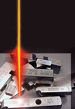

Solid-state Nd:YAG lasers are used to mark a variety of metallic and nonmetallic materials, and usually are used for beam-steered laser marking.
These systems deflect the laser beam across the surface much like a pencil on paper. Where the pencil deposits lead, the high-intensity laser light alters the workpiece material to create a contrasting image.

The Express10EV laser system (below) from Telesis Technologies (www.telesis.com) marks fine characters with high resolution on highly reflective silicon.
