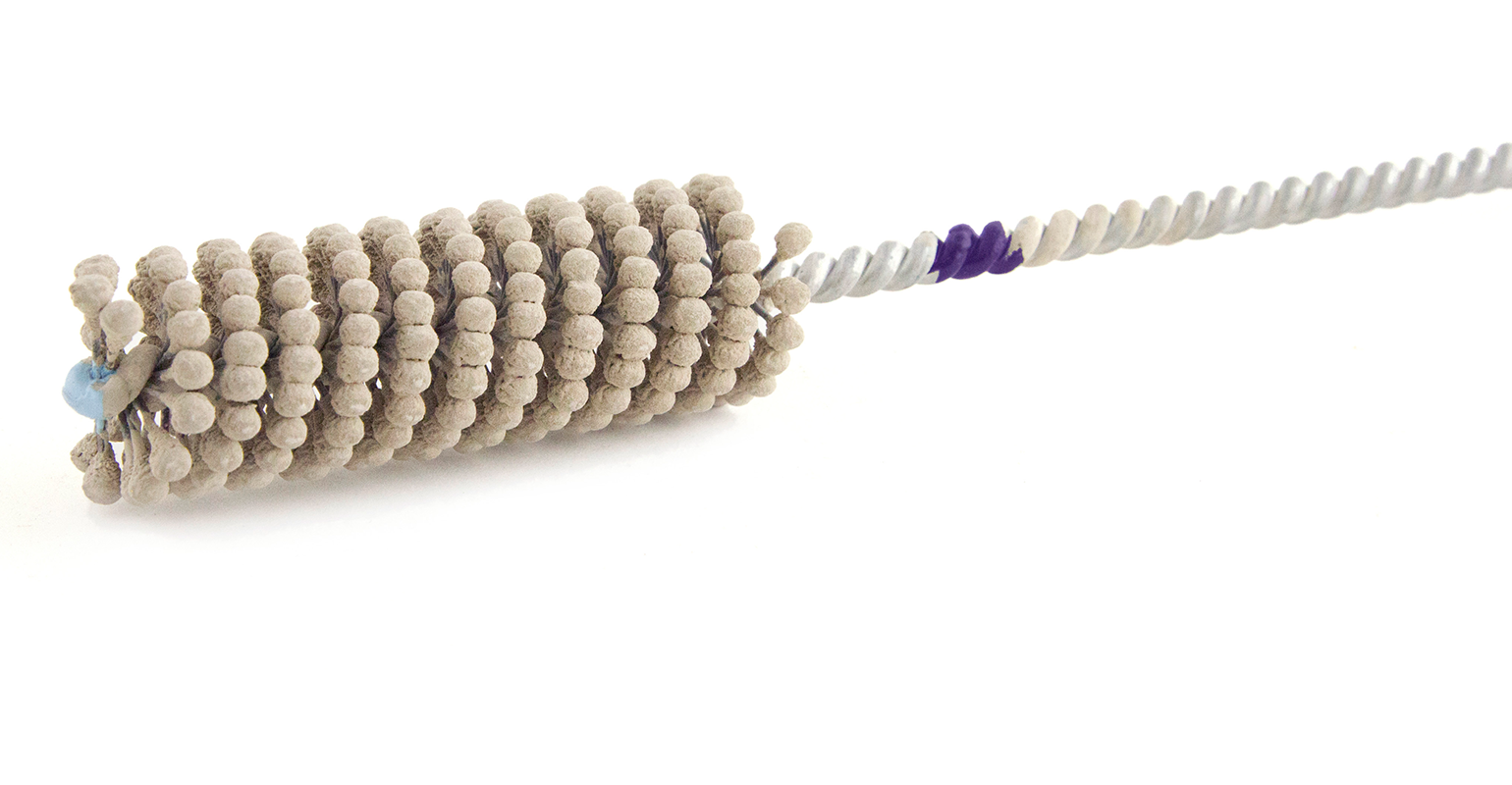

Flexible Hones — For many machine shops, a flexible hone is a much more efficient tool for overall surface finishing. Often such a low-cost tool is used for sophisticated surfacing, de-burring, edge-blending, and cleaning. Until recently, however, flexible hones with CBN abrasive were available only by special order. Now, the company that invented the Flex-Hone® tool, Brush Research Manufacturing, offers CBN surface-finishing solutions as part of its standard product line.
Somewhat resembling a spinning bottlebrush, the Flex-Hone tool is characterized by abrasive globules that are permanently mounted to flexible filaments, which are attached to a center shaft. With its low-pressure, low-temperature abrading process, BRM’s CBN Flex-Hone tools can remove work-hardened layers and deburr parts without disturbing the underlying metallurgical structure.
Standard CBN Flex-Hone tools are offered in sizes ranging from 4 to 20 mm, in three different mesh sizes: 170/200, 800, and 2,500. Larger-sized products from 22 to 38 mm, and additional mesh sizes, are available by special order.
