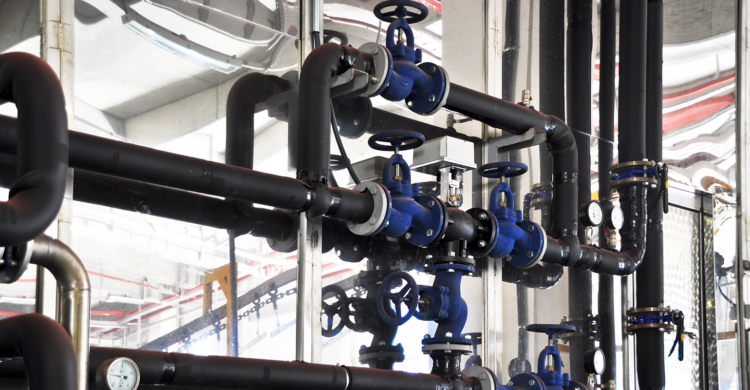

Zehra Başak | Dreamstime
Valves in a factory where the pressure system is controlled.
