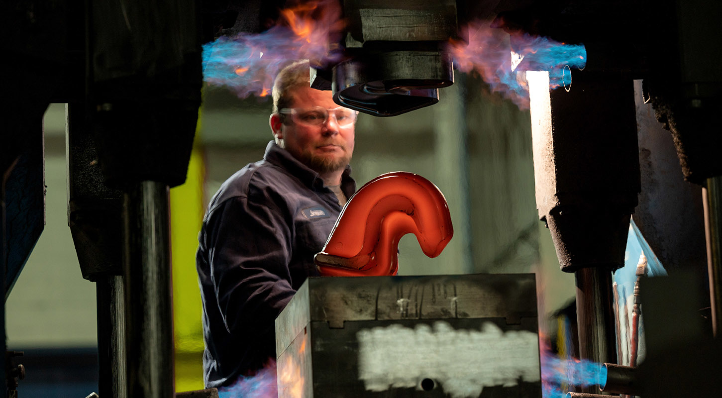

To produce large, complex titanium parts cost-effectively, Pennsylvania-based FPD Company, a producer of aerospace and medical components, decided to invest in a new custom press capable of greater control with higher tonnage.
“We wanted to increase our forged parts envelope, and that required a larger press with more sophisticated controls for the titanium parts. We already had a 2,500-ton press, which is relatively small for titanium. At the same time, we needed to improve control, quality, and cycle times,” explained FPD general manager Jeff Speicher.
To achieve its production goals, FPD partnered with Erie Press Systems, a manufacturer of mechanical forge presses and individually engineered hydraulic presses since 1895 that is now part of Ajax-CECO-Erie Press, the largest forging equipment supplier in North America.
Although Erie Press designed, engineered, and built the system, FPD provided significant input on the design requirements. The result was a customized high-speed hydraulic press capable of producing 3,000 tons at a fully controlled, programmable speed and load profile through full travel.
“The custom press, along with our engineering and tooling, allows us to hold extremely tight tolerances consistently when creating titanium parts for the aerospace and medical device industries. With the right equipment, the forgings are extremely consistent, and we can produce near-net shapes that require minimal to no machining. If a part needs additional machining for holes, bores, and other secondary features, we can do that as well,” Speicher explained, adding that FPD provides 5-axis CNC machining services on site.

The Erie Press forging equipment incorporates automation that allows the operator to change-out hot dies in less than 10 minutes. A forging change-over is completely hands-off, requiring only inputs to the HMI.
Titanium billet and workpieces are pre-heated in an electric furnace, while the tooling is pre-heated offline. The operator, working behind an interlock gate system for safety, uses a joystick to transfer the tooling into the press, which is hydraulicly clamped into place. A barcode is scanned on the production router, which calls up a part-specific forging program in the controller.
