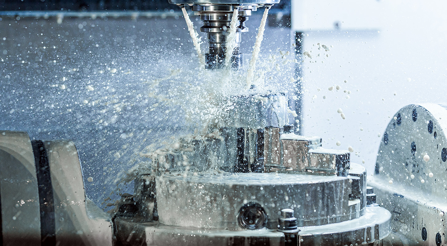

CNC machine shops are constantly seeking new ways to reduce costs and improve finished part quality. Many of them may be overlooking a significant opportunity to accomplish both mandates by focusing on improving the process of removing oil generated in various stages of machining. Whether “tramp” oil finds its way into coolant, or accumulates in parts washing baths, oil residues can degrade the performance of machining operations.
Tramp oil in coolant can clog lines and spray nozzles, shorten tool life, stain workpieces, and lead to inaccurate tolerances. The cost of replenishment and disposal of coolant is substantial. In parts washing, oil that is not removed accumulates and contaminates wash solutions, resulting in frequent bath recharging, and poor adhesion during painting or plating.
