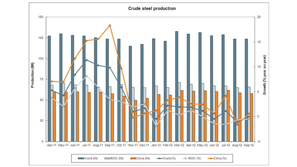

Eighteen months of production data show a global steel industry striving to maintain steady output against the challenges of an economy weakened by the worldrsquos debt crises
Global Steel Output Up for September, Just Barely

The World Steel Association reported global raw steel production totaled 123,637,000metric tons during September 2012, just slightly above the 123,637,000metric tons produced during September 2011. The Association explained the difference as “no change” versus the year earlier. However, for the year to date, global steel production stands at 1,149,417,000 metric tons, an increase of 0.6% over the 1,142,489,000 metric tons produced from January through September 2011, and 9.8% more than the 1,046,810,000 metric tons produced for January-September 2010.
Most of the regions for which World Steel tracks production report overall decreases in their September production totals, though the former Commonwealth of Independent States has increased its output by 5.7% over September 2011. Within the former C.I.S. — comprised of Belarus, Kazakhstan, Moldova, Russia, Ukraine, and Uzbekistan — the increase has been driven by Russia, where September production of 6,234,000 metric tons was up 15.1% over September 2011 (5,416,000 metric tons.) That country has now produced 53,777,000 metric tons this year, 4.3% over 51,538,000 metric tons produced January-September 2011.)
North American production (including Mexico, Central America, and the Caribbean) declined 2.5% during September versus September 2011, including a 3.0% decline last month in the U.S., to 7,015,000 from 7,233,000 during September 2011.
The region’s year-to-date total is up 3.9% to 92,792,000 versus 89,277,000 for January-September 2011. U.S. steelmakers have produced 68,154,000 metric tons of steel through the first nine months of this year, an increase of 5.3% over the September 2011 total of 64,726,000 metric tons.
