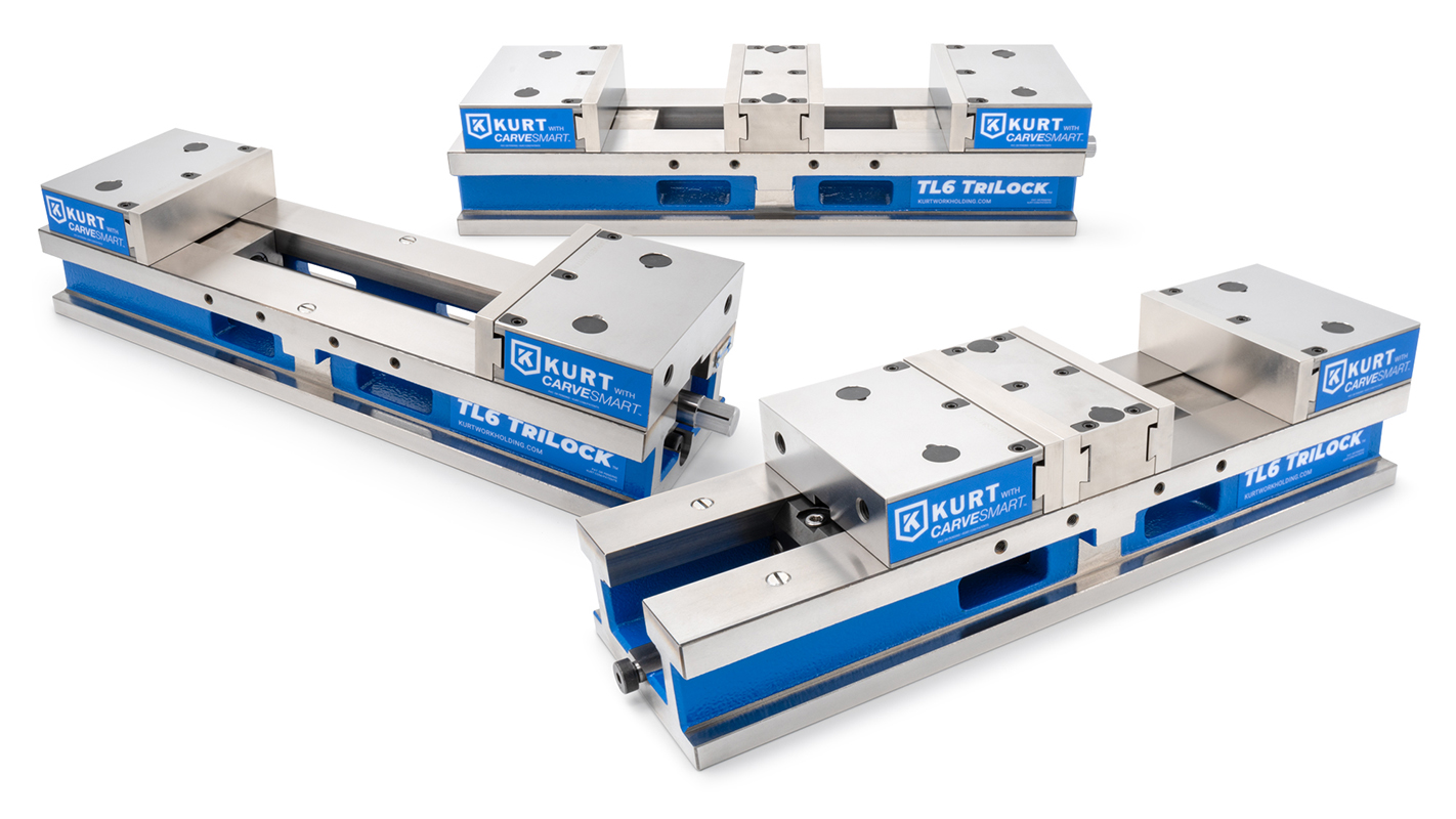

The TriLock quickly transforms from a single vise to one with three different styles, with fully integrated quick-change jaws.
KURT WORKHOLDING announced its new Kurt TriLock product line, featuring 3-in-1 vise design and integrated quick-change dovetail jaws from newly acquired CarveSmart. Six-inch Kurt TriLock vises quickly convert between three vise sizes and double-station or single-station configurations. CarveSmart dovetail jaws come standard for maximum workholding flexibility.
Preinstalled hardened steel jaw plates can quickly convert to CarveSmart machinable aluminum jaw extrusions or a wide variety of other CarveSmart jaw plate options for custom part holding and high-variability production work.
“The new TriLock vise is a leap forward in vise functionality for Kurt’s customers,” said Jeff Lenz, EVP of proprietary products at Kurt Manufacturing. “A shop can purchase a single TriLock vise, keep an inventory of CarveSmart machinable jaw extrusions, and quickly change between multiple complex part shapes on multiple jobs.”
TriLock vises with CarveSmart jaws are available with preinstalled hard jaws and a set of 6-inch extruded machinable aluminum jaws. Additional jaw extrusions are available with five different profile options in precut 4-inch, 6-inch and 8-inch widths. Jaw extrusions are compatible with the TriLock vise’s dovetail movable jaws and with other CarveSmart master jaw kits currently in the marketplace (at right). 31" and 94" extrusions are also available for customers.
TL6CSP TriLock Vises are designed to quickly convert between a standard, 6-inch double-station vise, a single-station vise and a large single station vise, and can hold parts as large as 11 inches.
