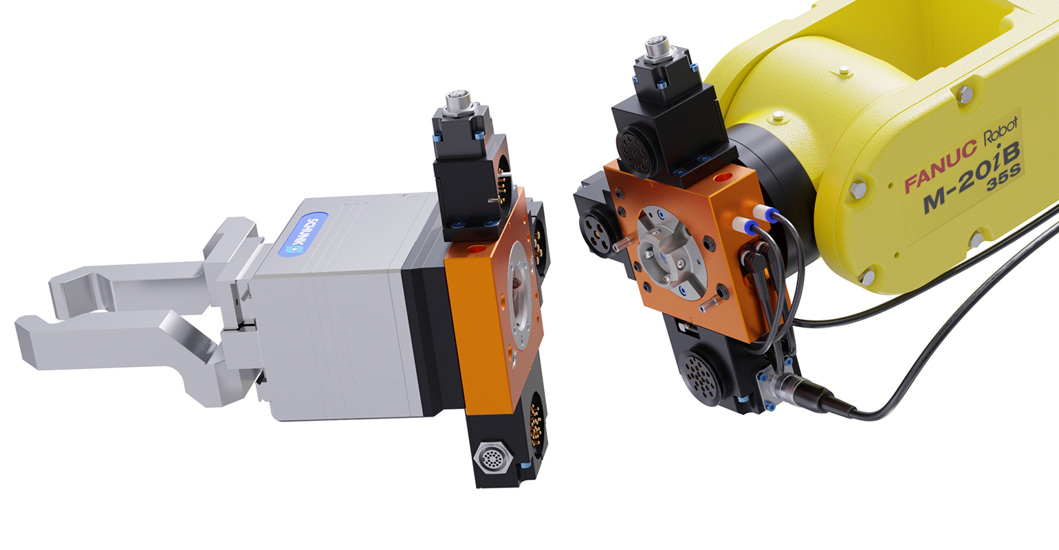

The QC-29 mounts directly to 40-mm and 50-mm robot wrists and includes in-body lock/unlock sensing plus a new locking mechanism.
ATI INDUSTRIAL AUTOMATION is releasing a new standard tool-changing option for smaller robots. The QC-29 robotic tool changer brings the powerful and rugged technology of ATI’s heavy-duty tool changers to robots in the 25- to 35-kg payload class. The QC-29 is the first standard ATI tool changer designed with a rectangular body that mounts directly to 40-mm and 50-mm robot wrists.
The QC-29 also includes in-body lock/unlock sensing and a new locking mechanism. Built-in air ports and three module-mounting flats make connecting utilities easy, and the Zero-Freeplay design ensures maximum repeatability for high-efficiency tool changing.
The QC-29 is compatible with ATI’s large selection of standard utility modules and tool stands enabling a vast array of unique configurations ranging from ultrasonic welding to servo motor support and more.
