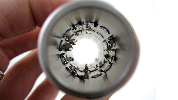

In automated machining, removing burrs and sharp edges in cross-drilled holes can be tedious and time consuming — and the problem also presents in similar difficult-to-access areas, such as undercuts, grooves, slots, or internal holes.  “Burrs” are the rough edges left on a cut surface after the tool has done its work, and deburring is the process of smoothing or finishing those edges. One particular challenge is deburring the intersection of cross-drilled holes frequently found in engine and transmission components.
Despite the challenges, removing burrs from the production process is absolutely essential for finishing high-quality, precision parts.  In many applications, cross-drilled holes act as conduits for fluids, lubricants and gases.  Failing to remove burrs can cause blockage of these critical passages or create turbulence in the flow.
Burrs can also lead to part misalignments, affect dimensional tolerances, and limit the overall efficiency of machined components.  “Getting rid of burrs is really important because if there is any loose material that gets dislodged when the product is in use, it can cause major problems,” said Anthony Scott, lead machinist at Orange Vise Company, a manufacturer of machine vises and quick change fixturing components.
Cross-drilled holes are produced to function as conduits for fluids, lubricants and gases. Failing to remove burrs can cause blockage of these critical passages or create turbulence in the flow.
