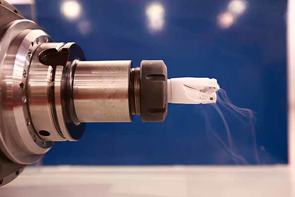

Cryogenic machining (cutting or turning) directs liquid nitrogen (e.g., -200° C) at the cutting tool and/or workpiece to cool the surface, thereby allowing higher speeds/feeds, and eliminating the need for standard coolants. Okuma and 5ME teamed up last year to demonstrate the effectiveness of cryogenic machining in industrial-scale operations, including faster processing sequences, longer tool life, increased part quality, and reduced environmental impact.
The 5ME process transmits liquid nitrogen at -321°F through the spindle/turret and tool body, just below the cutting edge, not only cooling the surface but increasing throughput, part quality, tool life, and profitability for the highly demanding titanium roughing and finishing process.
Reducing the temperature at the cutting surface helps to achieve faster cutting speeds, which makes liquid nitrogen-based cryogenic machining ideal for tough to machine materials. The system is self-pressurized, so no pumps and other power-consuming assets are needed.
5ME’s patented liquid nitrogen-based cryogenic technology allows LN2 to flow through the spindle and inside the tool just below the cutting edge, to optimize cooling. The reduction of temperature makes faster cutting possible, which is especially valuable for machining hard materials, like titanium.
5ME’s patented sub-cooler extracts pressure-generated heat from the system and condenses dual-phase liquid nitrogen (liquid and gas) back to 100% liquid, preventing the formation of gases from downstream heat leaks and pressure drops.

The integral Cryo Controller allows operators to program the flow rate to match requirements of the application. The cryogenic machining system can be retrofitted easily to almost any OEM spindle, and multiple tool interfaces are available. 5ME’s cryogenic tooling is specifically designed for the system and includes holders, turning and grooving tools, solid carbide mills and drills, indexable mills, drills, and boring tools. The developer will supply asset monitoring and manufacturing efficiency software, for cryogenic machining with any machine tool brand. Application engineering as well as tooling and coolant solutions are also offered.
For Lockheed, test cuts performed on 6AI4V titanium produced a 52% increase in cutting speeds (21 hours with 5ME cryogenics, versus 44 hours with coolant), and maintained an equivalent rate of cutter consumption. Tests using 5ME’s solid carbide cryogenic end mill also improved surface integrity and part quality, and reduced the white layer.
