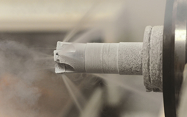

Liquid nitrogen is transmitted through the spindleturret and tool body to the cutting edge to cool the surface thereby allowing higher speedsfeeds

“Cryogenic” machining processes (cutting or turning) target the cutting tool and/or workpiece with liquid nitrogen (e.g., -200° C) to cool the surface, thereby allowing higher speeds/feeds, and eliminating the need for standard coolants.

5ME’s “multi-patented” cryogenic machining process transmits liquid nitrogen at -321°F through the spindle/turret and tool body, directly to the cutting edge, increasing throughput, part quality, tool life, and profitability in an environmentally friendly way that also reduces energy consumption.
Both cryo-machining demo locations will have Okuma machines outfitted with cryogenic systems that use vacuum-jacketed feed lines to deliver small flow rates of liquid nitrogen (LN2) through the tool directly to the cutting edge.
