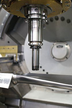

The test milling tool is a finish milling tool with a 0.7874-in. (20-mm) diameter.

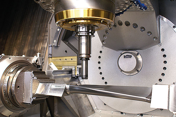

Liechti also is known for developing specific profile machining technology that allow its milling machines to machine complex parts completely in a single clamping operation, including highly dynamic roughing and finishing processes. This single clamping reduces chucking errors, set-up costs, and overall machining times by up to 30 percent. It also means dramatic increases in production efficiency and for of the turbine blades, impellers, and blisks.
The success of this technology and the single-clamping operation hinges on a tool clamping system that operates with maximum efficiency, can tolerate high-speeds, reduces wear and tear on tools, and operates flawlessly, even when cutting programs are pushed to their limits. For years, Liechti has relied on powRgrip, a revolutionary toolholding system from REGO-FIX specifically designed for precision and performance in high-speed machining.

Trummer also emphasized the importance of understanding the predicted behavior of the tool when manufacturing turbine blades to ensure their quality. As part of its design engineering process, Liechti regularly conducts comparison testing in its lab.
One test compared the powRgrip system with other toolholder systems using a 5-axis dynamic milling machine during the finishing passes on a 420A stainless steel blade.  Each toolholder assembly was 6.25 in. (~189 mm) long, with a constant feedrate of 281 in./min. (~7.1 m/min) with through tool and peripheral cooling for one hour.  Following the tests, the tools were viewed under a microscope.
“Using the microscope, we can precisely determine the behavior of the wear on the tool over the machining cycles, and discovered that the powRgrip system clearly outperformed the other systems we use in-house,” Trummer explained.
