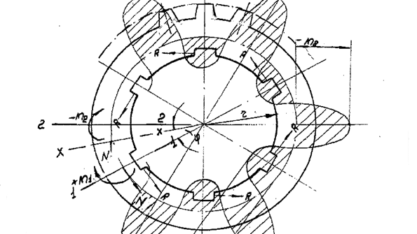

A section of Figure 2 see detail below illustrating the variability of torsion and bending

Fig. 1. A diagram — not to scale — of the bending moment at the intersection between the splines.
7. Now, we calculate the bending moments in the intersection between the spline (M1) and the spline (M2). See Figure 1.
For M1 = M x [(1-z/3.1416 x sin(3.1416/z)] x1/z (7) – MLG -7
For M2 = M x [cos(3.1416/z) – z/3.1416 x sin(3.1416/z] x 1/z (8) – MLG -8
For z = 4, M1 = + 0.025xM,  M2 = -0.048xM
                (9) — MLG - 9       (10) — MLG – 10
For z = 6, M1 = +0.008xM,   M2 = -0.014xM
               (11) — MLG - 11    (12) — MLG - 12
For z = 8, M1 = +0.003xM,   M2 = -0.007xM
               (13) — MLG - 13    (14) — MLG - 14
For z = 10, M1 = +0.0016 x M,  M2 = -0.0033xM
               (15) — MLG - 15    (16) — MLG - 16
For z = 16, M1 = +0.0008 x M,  M2 = -0.0005xM
               (17) — MLG - 17    (18) — MLG – 18
Fig. 2. This diagram — not to scale — illustrates that the moments for torsion and bending are variable.
See Figure 2.
We see that with M1, with (+) sign, and M2, with (-) sign, indicates that variable moments + M1 and -M2 are cause of the pitting on the splines. As we see more z than less moments on the splines, and this must be taken into account by the tool designer.
