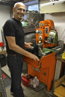

Gary Conley in his shop with the Sunnen MB 1660 hone. Sunnen engine experts helped him determine that plateau honing would resolve the problem of excess oil in the engine’s cylinders. Plateau honing – a second pass with a brush or milder abrasive – removes the surface peaks left by the initial pass. It creates a surface profile that resembles a series of plateaus, providing a much greater bearing area, while maintaining the crosshatch valleys for oil retention.

According to Conley, the first units of the Stinger engine burned oil so badly they filled a room with smoke in seconds. He discovered the problem was too much oil being pushed up into the cylinders, and though he did not realize it at the time, his honed cylinder surface was too smooth.
"The problem was that the molecular size of oil does not scale down," he explained. "I thought this was caused by the rings, and spent months assembling engines, making new liners, honing and decking the liners, re-designing the rings and pistons, and testing to no avail."
Digging deeper into the science of ring and cylinder design, he learned about the nuances of crosshatch, including the proper angle and depth required to create valleys to retain the oil. “At the time, I did not associate Sunnen with a solution to the problem," Conley said. "I was honing with the MB 1660, but came to learn my surface finish was too smooth. So, I got a very coarse, 80-grit, 5-hardness J25 silicone carbide honing stone. This produced nice surface valleys for the oil to be retained, but I had not accounted for the surface peaks.
“After installing rings with an end gap of 0.003-0.004 in., and running the engine, the end gap suddenly increased to 0.012 in., because the rings were abrading the peaks off the cylinder finish, and the oil issue returned,” he explained. “Bear in mind, we are using stepped cast iron rings only 0.062-in. thick, without an oil control ring because there's no space for one.”
After consulting with Sunnen engine experts, Conley determined that plateau honing was the answer. Plateau honing – a second pass with a brush or milder abrasive – removes the surface peaks left by the initial pass. It creates a surface profile that resembles a series of plateaus, providing a much greater bearing area, while maintaining the crosshatch valleys for oil retention.
“I once ran a set of new rings in a cylinder that had been plateaued and one that was not," Conley added. "The plateaued cylinder had no ring wear after run-in. The end gap did change slightly, but this is probably cylinder wear rather than ring wear, because so much happens so fast in these small engines."

“I learned decades worth of information about honing from Sunnen," he said. "Learning how to line hone an engine block straight and true was quite an achievement. We could not get the tandem cam and crank bores on the same centerline without this. Using a three-stone mandrel, I can hold 0.001 in., end to end, on a six-inch workpiece.
