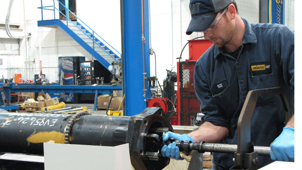

An operator inserts a tool in the honing machine at the start of a cycle Whane Supply hones cylinders with bore IDs up to 17 in The HTA tubehoning system supplied by Sunnen handles parts weighing up to 8000 lb 3629 kg with ID ranges from 25 to 21 in 635 to 533 mm

The Corbin shop's previous hone consisted of a drill motor on a sliding carriage, and lacked the power, capacity and rigidity needed for doing serious work, according to Carter. "It could produce a surface finish, but not remove metal."
Whayne agreed to beta test Sunnen's all-electric HTA cylinder hone, and later purchased the machine with a 12-foot (4 m) part capacity.
The HTA tube honing system handles parts weighing up to 8,000 lb. (3,629 kg), with ID ranges from 2.5 to 21 in. (63.5 to 533 mm.) It is designed to resurface and repair machinery and parts requiring light-duty stock removal up to 0.030 inches (0.76 mm.)  Standard models are sized for 6-ft (2 m) and 12-ft (4 m) part lengths, and custom lengths are available, too.

"We were not sure about downtime for a new machine,” Carter continued, “but it has proven extremely reliable and we've used it to hone cylinders from 2.5 to 17 inches (63.5 to 432 mm) diameter, and six inches (152 mm) length to over 21 feet (6.4 m)," Carter added.
"We simply created a table with an adjustable-height V-block to support parts that overhang the machine. We have used up to a 21-foot drive-shaft length on the machine, and we can hone from both ends of the part if need be. Our cycle time for most barrels is about 30 minutes, which includes setup, honing and washing the part," he said.
Whayne uses both roughing and finishing abrasives, removing scratches and rust, and imparting a specific crosshatch surface finish on the barrel bore. "We can increase the cylinder bore diameter up to 0.254 mm (0.010 in.) in aa relatively short time, removing rust and all but the worst scratches, and remain within Cat machine specifications," Carter said. "Our old hone simply could not do this. The HTA hone is easy to setup also. The control calculates the correct crosshatch angle. It's been a very reliable system, too, with no appreciable downtime.
