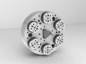

SMW Autoblok will introduce their new TE Six Jaw Chucks with 2 + 2 + 2 equalizing mechanisms. These active pull down chucks feature high precision and repeatability and are designed to securely clamp parts without deformation. With six equalizing ...
With six equalizing jaws, TE Chucks clamp workpieces with twelve points of contact. This is ideal for parts that are easily deformed, such as flanges and rings for the aerospace industry, fly-wheels, components for wind power generators (e.g. bearings, slewing rings and planetary gear boxes), brake drums, and brake discs.
With high centrifugal force compensation even at high speed, TE Chucks maintain low static gripping force for minimum workpiece deformation. Despite the intricate mechanism of master jaws and levers, TE Chucks feature a compact body design.
TE Chucks are completely sealed from outside contamination and will be available in a range of diameters from 260mm (10.24”) to 1050mm (41.39”).
