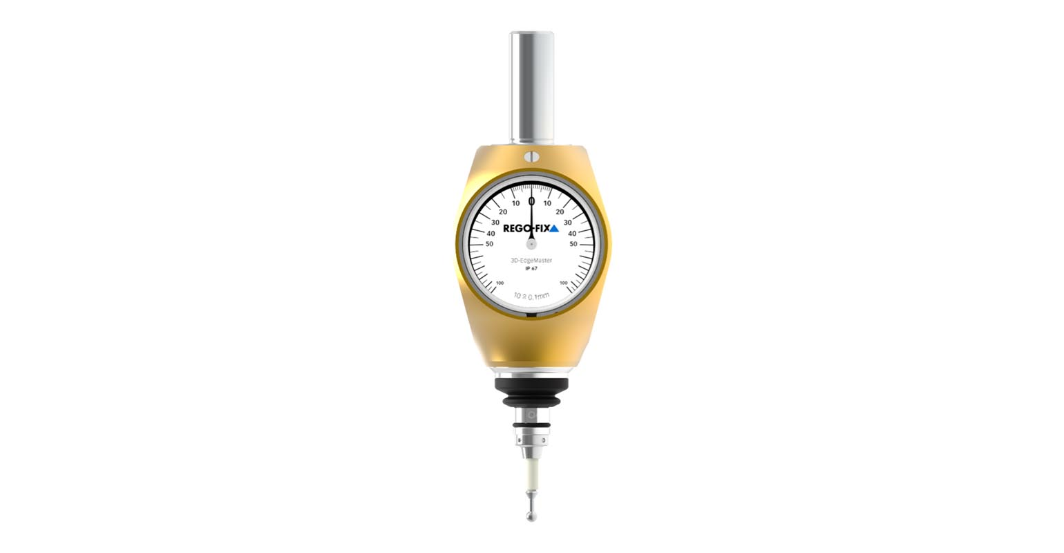

To add REGO-FIX precision to set-up measurements, ergonomic 3D-EdgeMaster centering devices shorten set-up time and ensure part accuracy in an IP 67-compliant, shockproof and splashproof design. Designed to set zero points, probe reference edges and workpieces, calibrate measuring paths, center machine axes and determine bore centers, these new devices feature repeating accuracy of ≤0.01 mm. 3D-EdgeMaster is available in metric and inch sizes and with short or long probes, all individually serial numbered, with fully traceable inspection and performance certification for demanding industries.
