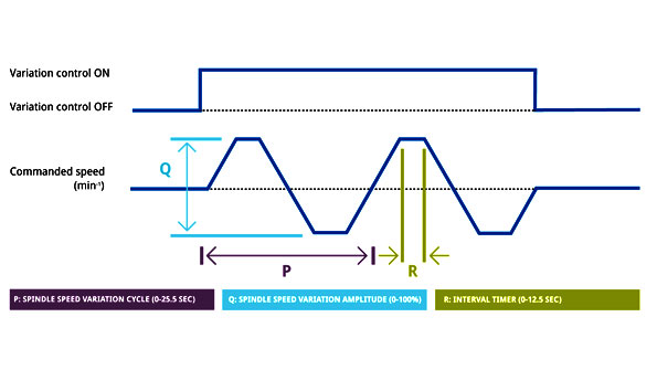

Now, machinists can use the HSSC function built into Okuma’s control to alternate the RPM of a CNC lathe spindle on a constant basis in order to prevent harmonics or chatter (see diagram).
With this function, the OSP control (along with some NC code) automatically adjusts the following variables according to pre-set parameters, or parameters that are programmed to suit particular tasks:
•  Amplitude (Q): the percentage amount of variation in the RPM
•  Interval time (R): how long to remain at the peak or valley of RPM change, and
•  Speed variation cycle (P): the pitch of the RPM variation.
The result is reduced or eliminated chatter during turning operations.
