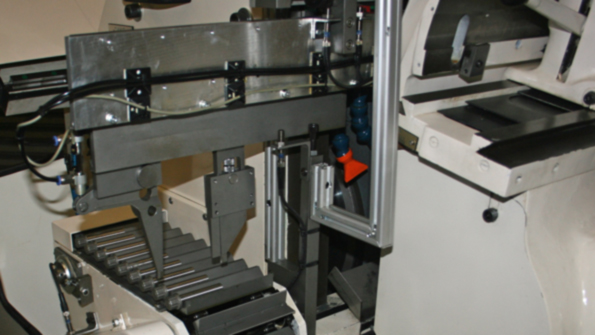

Another noteworthy feature is a choice of drop-, finger- or front-loading loaders to automate the broad range of common centerless grinding applications. The finger loader accepts a very large variation in part size, from 10 mm long x 3mm diameter, up to 200 x 25 mm.
