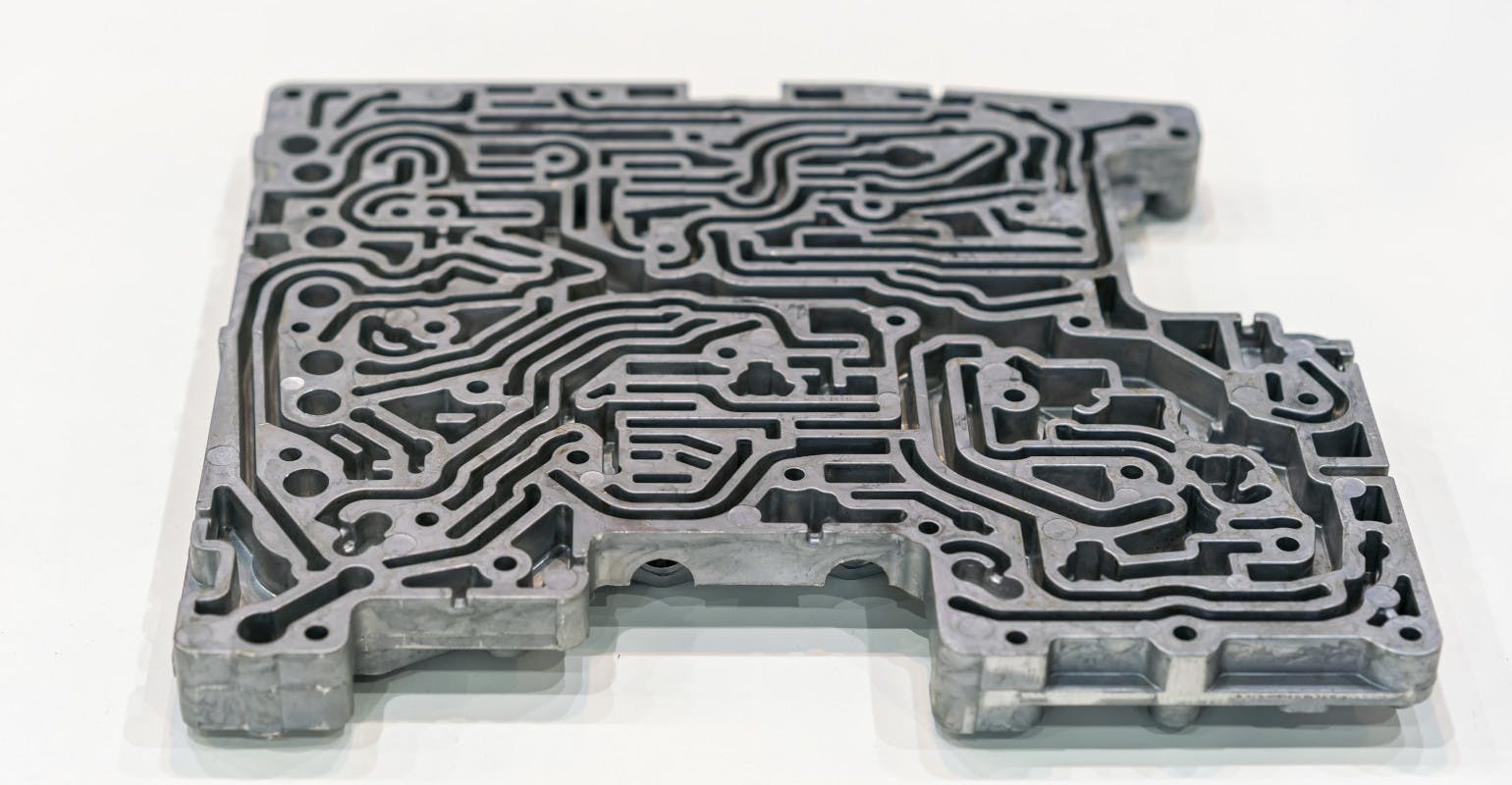

On the subject of rapid prototyping, 3D printing often dominates the conversation. The speed, digital flexibility, and low initial investment that additive manufacturing offers have made it 3DP that default in many engineering and product development circles. But casting — often underestimated in early-stage design — offers advantages that 3D printing simply can’t match, especially when material performance and production realism matter.
For metalcasting professionals and advanced manufacturers, knowing when to choose casting for prototyping can mean the difference between functional insight and costly misdirection.
Understanding casting’s role
Casting is typically associated with full-scale production, but it can be equally powerful in the prototyping phase. Foundries equipped with flexible patterning methods, such as 3D-printed molds or CNC-machined patterns, can deliver short-run castings in days rather than weeks. More importantly, they deliver production-grade metal properties that additive prototypes cannot replicate.
Casting becomes particularly relevant when a prototype must be tested under real-world conditions — stress loads, thermal cycling, wear, or fatigue. These are cases where plastic 3D prints, or even metal sintered parts, fail to deliver meaningful data. Whether you're developing a new alloy housing or validating a pressure-resistant valve body, casting brings you closer to the actual performance envelope of the final product.

  • Sand casting. Best for larger parts or when minor tolerance trade-offs are acceptable. Quick turnaround using 3D-printed molds or CNC patterns.
  • Investment casting. Ideal for complex geometries, tight tolerances, and smooth finishes. Best when the prototype doubles as a pre-production benchmark.
  • Shell mold casting. Excellent for medium-to-high precision iron castings. Great for structural parts with tight wall thickness variation.
  • Permanent mold casting. Used when multiple high-fidelity prototypes are needed quickly, and tooling costs are justified.
Some foundries now employ additive manufacturing technologies together with casting, e.g., to print wax patterns for investment casting, or sand cores, to accelerate delivery. This hybrid approach avails the foundry of the speed of 3DP as well as the design integrity of poured and solidified metal.
