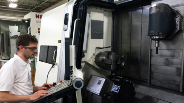

Indiana Gearrsquos Joel Neidig using the MTConnect Glassware app on the shop floor at Indiana Gear

Joel Neidig, an engineer at the Plymouth, Ind., manufacturer of open gearing and precision-machined parts for heavy-duty industries including mining, off-highway vehicles, marine, and aviation, has linked one recent machining innovation, MT Connect — with an even more recent networking breakthrough, Google Glass.
Google Glass is a ‘wearable’ devive that combines a camera, touchpad, and a microphone, with an email account and Internet connection, all of this condensed into a spectacle frame. The operator wears it just like safety glasses, and gains visible contact with all manner of information technology relating to the performance of a machine and the reference tools that define the operating standards.
In parallel to this is MT Connect, a network protocol for gathering, storing, monitoring, and reporting machine tool data, designed for exchanging information among manufacturing systems and servers.
Neidig connected the MT Connect functions with the Google Glass applications, to develop the MT Connect Glassware app. The app’s users (or, wearers) are free to move about the shop, with no other hardware except the spectacle frame, gathering and sharing machine data via MT Connect, and linking to online sources for more information.
