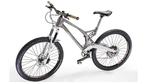

The finished mountain bike with a frame assembled from titanium parts produced by additive manufacturing
Customized Titanium Cycle Frame... Redesigned, Printed and Assembled

Empire Cycles designed the mountain bike for lightness and durability, using a process called “topological optimization.” It deployed Renishaw’s AM250 additive manufacturing system to produce the individual parts, and giving it a new range of design possibilities.
Additive manufacturing offers design, construction, and performance advantages that include blending complex shapes or hollow structures with internal strengthening features; flexibility to make design improvements right up to the start of production; and the convenience of making single parts as easily as batches, which means a high degree of design customization.
The new titanium alloy frame for the mountain bike — reportedly about 33% lighter than the original design — was produced in individual pieces that were later bonded together.
Originally, the partners’ plan was to optimize the design of and manufacture only the bike’s seat post bracket; after the part’s successful production, improving the whole frame became the new goal.
Empire started with a full-size 3D printed replica of its current aluminum alloy bike, and the frame was sectioned into parts that could be formed in the AM250’s 12-in. (300-mm) high build envelope. The design was updated with data supplied by Renishaw’s applications team, and an optimized design was created using topological optimization – it eliminated many of the downward facing surfaces that require unwanted support structures.

The original aluminum alloy seat post bracket weighs 12 oz. (360 g) and the first iteration of the hollow titanium version is 7 oz. (200 g), a weight savings of 44%. Comparing the entire frames of the original and optimized designs, the original bike frame weighs 4.6 lbs. (2,100 g); the redesigned frame produced by additive manufacturing weighs 3.1 lbs. (1,400 g), a savings of 33% in weight.
