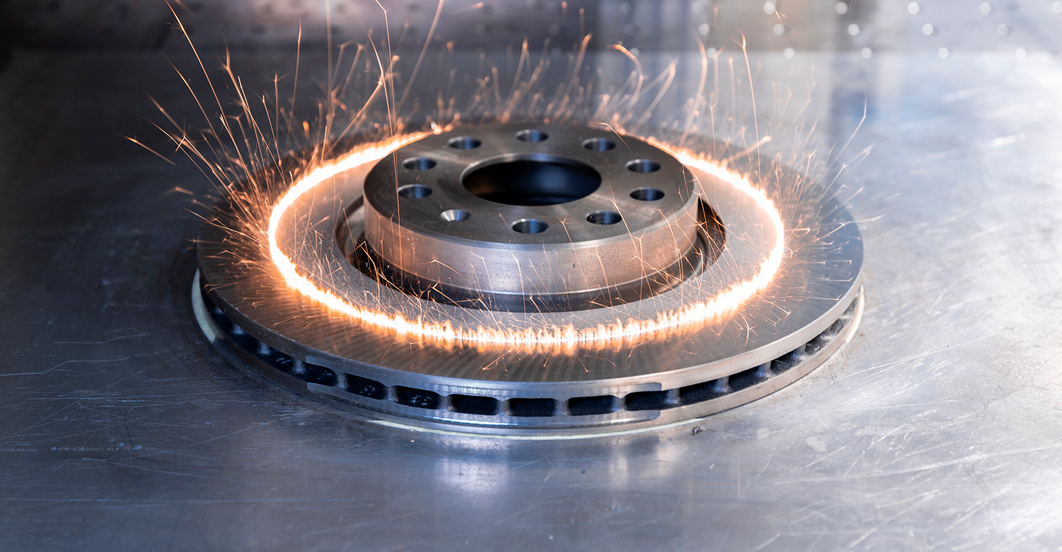

Fraunhofer IWS used high-energy light instead of sand grains to clean and roughen – for example the surface of brake discs. For this purpose, researchers developed a laser-based process that realizes cleaning and structuring tasks significantly faster than conventional processes and should result in lower operating costs in series production.

In one case, researchers at Germany’s Fraunhofer Institute for Material and Beam Technology IWS developed a laser-cleaning method superior to traditional sandblasting. They created the LIGHTblast process, which uses no chemicals and does not require sand or masking tape.
In experiments, the Fraunhofer team used a laser cleaning machine to get uniform results regarding the friction band surface condition of brake disc blanks before they are coated. They automated the process and made it more cost-effective. Researchers claim this process would make brake discs more affordable and lengthen their life spans. The waste reduction caused by products that last longer before requiring replacement contributes to better sustainability.
Researchers on this study said their laser-based system also would minimize the particulate matter generated by vehicles using the brake discs treated with this cleaner.
And, the laser beam’s diameter is much thinner than the streams used in traditional sandblasting, and researchers confirmed how that characteristic would improve accuracy while allowing users to make further adjustments to alter the resulting surface roughness.
