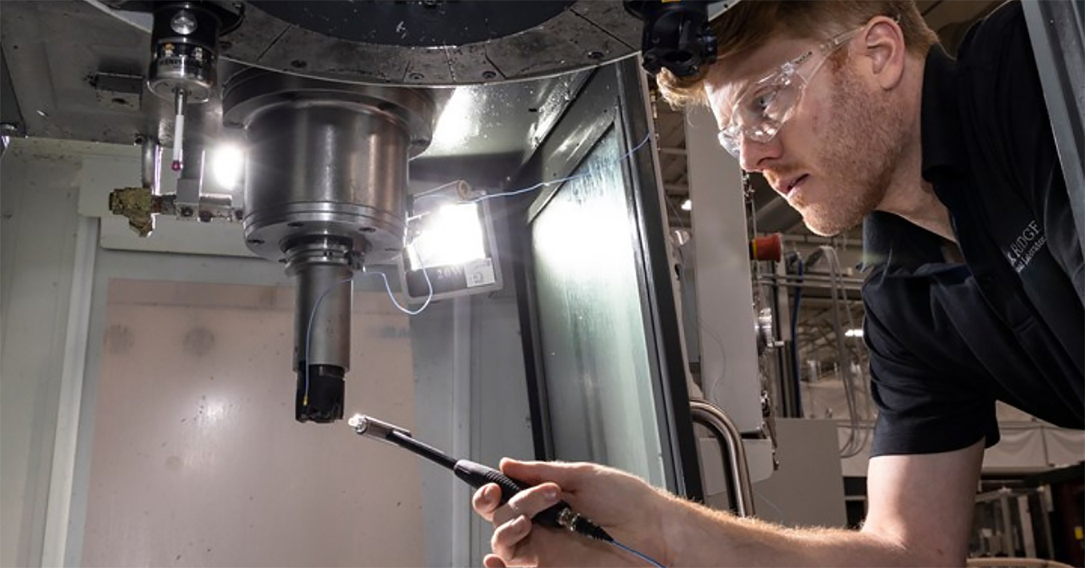

This type of information is only gained through a brief tap test. Fifteen minutes or less. The benefits are improved Metal Removal Rates (MRR), improved surface finish and/or greater tool life. Upon administering hundreds of milling tests in just about every material, the average MRR improvement is over 300%. Yes, four times more productive. Cycle times for milling operations are 50% lower, on average, after the measurement, and capacity gained is typically over 100 annual hours. These application outcomes create a more productive and profitable machining business.
