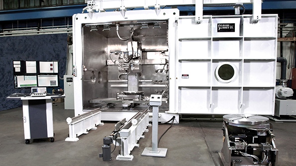

The EBAM 110 system converts titanium or other alloy wire into nearnet shapes up to 19 ft long at a rate of 720 lbhour in a work envelope of 70x47x63 inches

Chicago-based Sciaky Inc., a developer of metal additive manufacturing systems, will deliver one of its EBAM110 systems this month, for 3D-printing large structural parts in titanium.
The EBAM process converts alloy wire (e.g., metal or refractory alloys) via an electron beam heat source, to build 3D parts according to data derived from a CAD model. The machine’s fully articulated, moving electron-beam gun deposits metal via wire feedstock, layer by layer, until the part reaches near-net shape.
The near-net shape parts are heat-treated and finish-machined. In the end, there is minimal material waste.
The Sciaky EBAM 110 system has a work envelope of 70x47x63 inches (1,778x1,194x1,600 mm), and can produce parts ranging from 8 inches (203 mm) to 19 feet (5.79 meters) long. EBAM gross deposition rates range from 7 to 20 lbs. (3.18 to 9.07 kg) of metal per hour.
