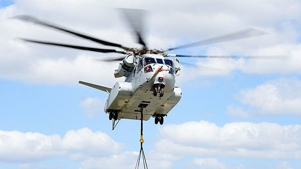

The CH-53K King Stallion helicopter carries an external load for the first time at the Sikorsky Development Flight Test Center in West Palm Beach, Fla.
Lockheed Martin reported that its CH-53K helicopter passed an important test in the aircraft’s development, the first external lift flight, successfully carrying a 12,000-lb. external load. "Achieving our first external lift signifies another milestone for the CH-53K program," stated Mike Torok, vice president for the Sikorsky CH-53K programs.

The CH-53K King Stallion is equipped with single, dual, and triple external cargo hook capability that will allow for transfer of three independent external loads to three separate landing zones, in support of distributed operations in a single sortie, without having to return to a ship or other logistical hub. The three external cargo hooks include a single center-point hook with a 36,000-lb. capability and dual-point hooks each capable of carrying up to 25,200 lbs. The system has electrical load-release capability from the cockpit and cabin, and mechanical load-release capability at each of the pendant locations.
An auto-jettison system is incorporated to protect the aircraft in the event of a load attachment point failure.
A third and fourth King Stallion aircraft will join the flight test program this summer. As the tests proceed, the two current flying aircraft will have their external-load envelopes expanded: Initial external payloads weighing 12,000 lb will be flown first in hover, and then incrementally to speeds up to 120 knots. Then, the aircraft will carry 20,000- and 27,000-lb. external payloads.
