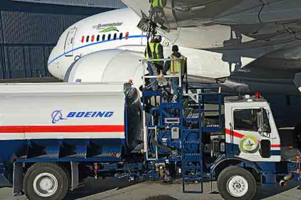

Boeing powered its ecoDemonstrator 787 flight test airplane with a blend of 15 ldquogreen dieselrdquo and 85 petroleum jet fuel in the left engine

Boeing Commercial Airplanes reported it completed the first flight powered by "green diesel," a biofuel made from vegetable oils, waste cooking oil, and waste animal fats, and widely used in ground transportation.
A Boeing ecoDemonstrator 787 flight test airplane was fueled with a blend of 15% green diesel and 85% petroleum jet fuel in its left engine. The flight test was coordinated with the U.S. Federal Aviation Administration, Rolls-Royce, and Pratt & Whitney, and EPIC Aviation blended the fuel.
"The airplane performed as designed with the green diesel blend, just as it does with conventional jet fuel," according to the chief pilot for Boeing’s Product Development and 777x Test and Development, Capt. Mike Carriker. "This is exactly what we want to see in flight tests with a new type of fuel."
