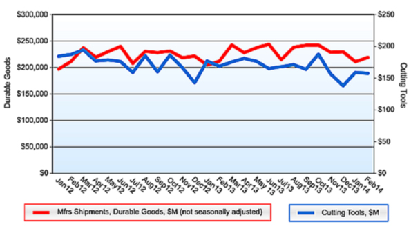

Cutting tool consumption continues to run counter to the trend for manufacturers’ durable goods shipments, a pattern that emerged late in 2013.
In February, consumption of cutting tools by U.S. machine shops and other manufacturers slipped slightly from the January total — down 1.2%, from $158 million to a new total of $157 million — and more so from the year-ago result from February 2013.  The new figure is 6.8% less than the total recorded for February 2013.

“The trend is certainly on an upward climb as incoming orders have indicated a strong finish for the first quarter of the calendar year,” according to USCTI president Tom Haag.
The USCTR is a recently developed report that AMT and USCTI introduced less than a year ago, calling it their “first step” to promote and support domestic manufacturers of cutting tools. The lack of a long history of reporting makes it difficult to judge trends in the market.
However, the new result resumes a wavering sequence in the monthly reporting. While January totals indicated a robust improvement after two months of decline, it’s possible that the February report is an indicator of a short month and/or weather-impaired manufacturing activity.
