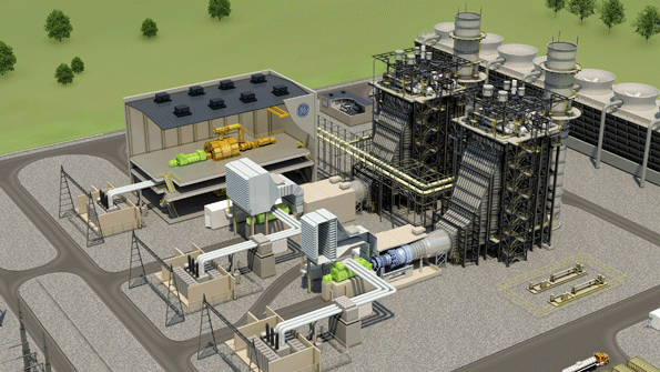

GErsquos FlexEfficiency 60 plant concept would be installed to coordinate with other generating sources and able to raise or lower its power output in response to fluctuations in wind and solar power This would allow power companies to integrate more renewable resources onto the power grid According to GE if one equivalentsize coal plant were replaced with its FlexEfficiency 60 plant the offset carbon emissions would be 26 million metric tons per year

The FlexEfficiency 60 Portfolio will include four gas turbines in different configurations, in ratings from 185 MW to over 300 MW.The new portfolio also includes an enhanced steam turbine, hydrogen-cooled generator, and integrated control system that can be configured into the FlexEfficiency 60 combined-cycle power plant.
FlexEfficiency 60 turbines will be manufactured and tested at GE’s manufacturing plant in Greenville, S.C., the world’s largest gas turbine plant. Following development costs of $500 million for the new portfolio, GE also installed $170-million testing center at that location.
The core of the FlexEfficiency 60 package is a Combined-Cycle Power Plant capable of exceeding 61% thermal efficiency, and able to rapidly increase or decrease its power output quickly in response to fluctuations in wind and solar power, making it a suitable complement to that will enhance those projects.
