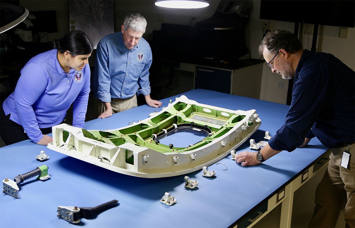

National Transportation Safety Board inspectors study a 737 MAX 9 mid-cabin emergency (MED) door.

The National Transportation Safety Board’s preliminary report on the January inflight structural failure identified the nonconforming assembly of the jet’s mid-cabin emergency door.
The National Transportation Safety Board’s preliminary report on the January 5 incident in which a Boeing 737 MAX 9 jet lost a fuselage panel during flight revealed that four bolts holding the door plug in place were lost in the incident. The “mid-cabin emergency door” (MED) plug is installed during aircraft assembly to fill an open space available as an optional side door.
“Overall, the observed damage patterns and absence of contact damage or deformation around holes associated with the vertical movement arrestor bolts and upper guide track bolts in the upper guide fittings, hinge fittings, and recovered aft lower hinge guide fitting indicate that four bolts that prevent upward movement of the MED plug were missing before the MED plug moved upward off the stop pads,” according to the NTSB preliminary report.
According to NTSB, the door plug had been removed and reinstalled at Boeing’s Renton, Wash., assembly plant prior to the aircraft’s deliver to Alaska Airlines in October 2023. The board did not state whether the panel had been reinstalled by Boeing or the fuselage manufacturer, Spirit AeroSystems.
Both Boeing and Spirit AeroSystems have confirmed that some of the fuselage structures delivered for the 737 MAX 9 aircraft have been found to have nonconforming assembly
