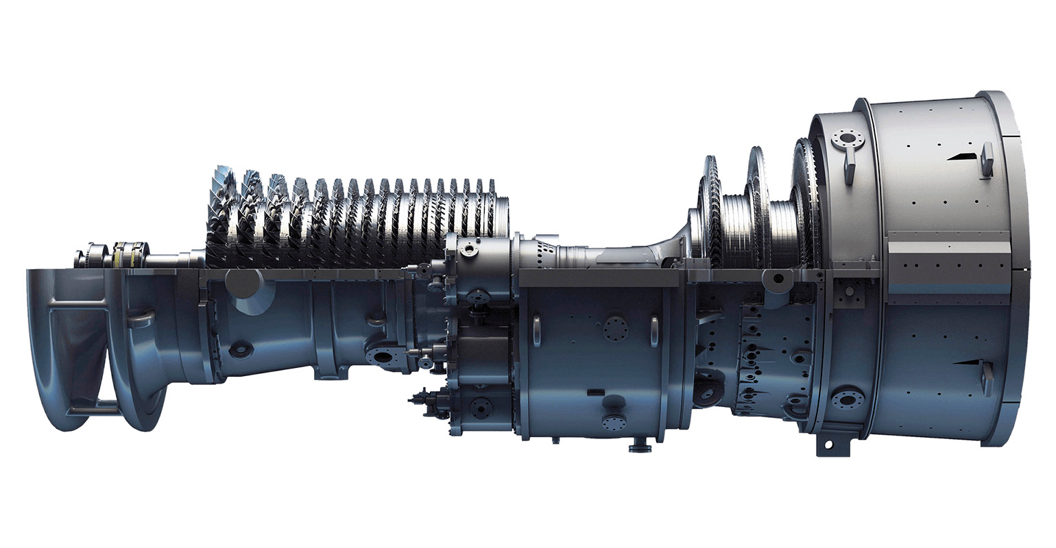

A GE 7E gas turbine.

GE Vernova will modify the 7E gas turbine gas turbine infrastructure at the DeBary plant, including the fuel handling systems, valves, and piping compatible with higher blends of hydrogen operation and up to 100% hydrogen (by volume). GE also will install a fuel skid with hydrogen blending, finalize control modifications, and support overall integration of the project to support 100% hydrogen operation.
When fully operational, the converted 83-megawatt gas turbine will have the flexibility to operate on natural gas, liquid fuel, 100% hydrogen, or a blend of natural gas and hydrogen.
Production, storage, and end-use of the green hydrogen will be co-located at the DeBary power plant, which includes a 74.5-MW solar power plant and a 692-MW gas power plant, driven by six GE 7B gas turbines and four GE 7E gas turbines.
GE Vernova will support integration of the turbine with green hydrogen, including the upgrade on one of the GE 7E gas turbines to accommodate hydrogen fuel blends of significant volumes.
