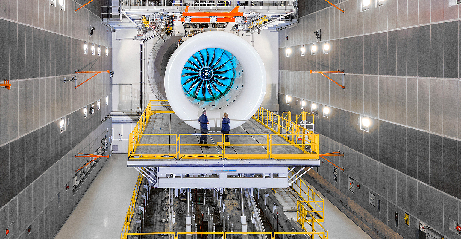

The UltraFan demonstrator engine at Rolls-Royce’s Testbed 80 in Derby, England.

Rolls-Royce reported it completed initial tests of its UltraFan technology demonstrator at its testbed in Derby, England, the world’s largest indoor aero-engine testing facility. It’s the first test of a new aerospace engine architecture completed by Rolls-Royce in more than half a century, and the tests were conducted using 100% Sustainable Aviation Fuel (SAF), it emphasized.
Rolls added the successful test confirms the ability of its suite of new engine technologies to improve the efficiency of current and future aircraft engines.
The UltraFan is a large-dimension demonstrator engine that Rolls has been developing for nearly a decade, incorporating geared turbofan technology with a 140-inch fan diameter and comparatively small core to achieve fuel efficiency while delivering exceptionally high propulsion power for wide- or narrow-body aircraft.
The demonstrator engine incorporates a new engine-core architecture (Advance3) in combination with a “lean burn” combustion system, to maximize fuel-burn efficiency and low emissions. The carbon-titanium fan blades and a composite material engine casing reduce the overall weight of the engine significantly over current designs, and the geared design delivers efficient power for the high-thrust, high-bypass ratio engines envisioned for future aircraft design
