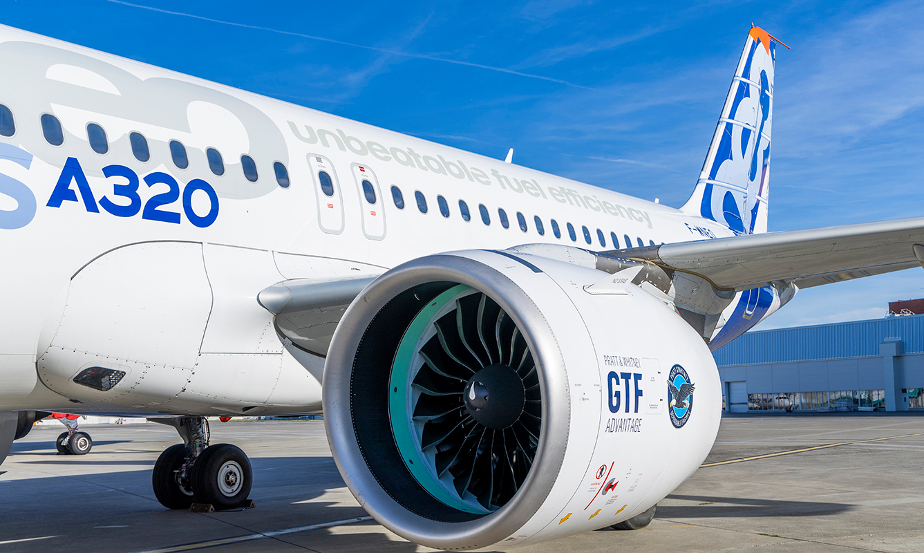

The Pratt & Whitney GTF Advantage test-mounted on an Airbus A320neo jet.
