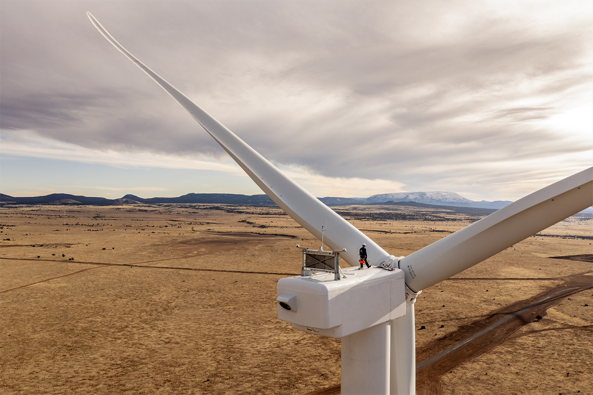

GE’s Sierra series wind turbine, installed at Borderlands, N.M.

The 3.0- to 3.4-MW Sierra turbines developed for the North American market will be manufactured in the U.S., and have a 140-meter rotor and can be positioned up to 500 ft high.
GE Renewable Energy introduced a new onshore wind-turbine platform designed specifically for North America installation. The Sierra series 3.0- to 3.4-MW turbines incorporate a 140-meter rotor and are available with a variety of hub heights, including a 500-ft option. The design also includes GE’s two-piece blade, designed to improve logistics, installation, and serviceability.
GE will manufacture Sierra turbines at its Pensacola, Fla., plant, a significant portion of its components manufactured in North America. The 68.7-m, two-piece blades are manufactured by GE’s LM Wind Power subsidiary and TPI Composites.
GE reported it has logged more than 1 GW of orders for the turbine platform.
Among the design advantages of the new turbines, GE noted Sierra’s high-capacity factor (+4 pts capacity factor with 15% less pads needed per 100 MW, compared to 2-MW turbine); a two-piece blade for reduced logistics, improved site installation and improved serviceability; simplified machine head and electrical system, based on GE’s 2-MW platform; and optimized three- and four-section towers for ease of transport and installation.
The Sierra platform was launched with two prototypes, one in Lubbock, TX and one in India, with more than a year of successful run time on each. Those first Sierra turbines exceeded 98% availability faster than GE’s previous onshore platform launches to date, and are operating with a four points higher capacity factor than GE’s 2 MW platform.
