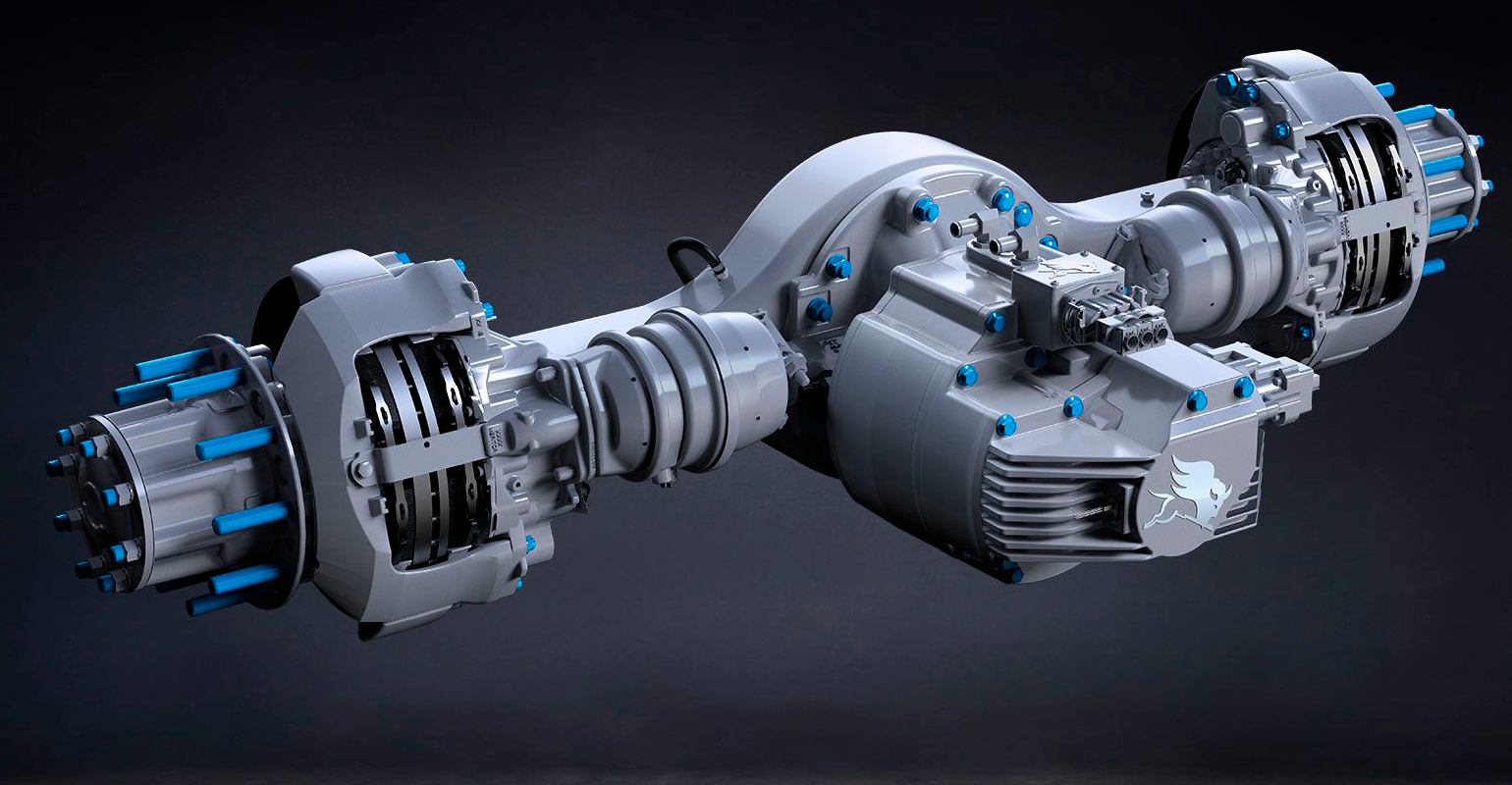

Meritor 14Xe™ ePowertrain all-electric drive system for Class 5-8 commercial vehicles.

The 14Xe ePowertrain is said to be the only integrated electric powertrain in production for Class 8 trucks in North America – and maintains existing axle-mounting hardware to simplify OEM integration.
Drivetrain developer Meritor Inc. will launch production for its 14Xe ePowertrain all-electric drive system this month in Asheville, N.C. The manufacturer also announced the first customer for the new technology, which it describes as “the only integrated electric powertrain in production for Class 8 trucks in North America.”
The 14Xe ePowertrain is based on Meritor’s established 14X axle housing for heavy-duty commercial vehicles, which maintains existing axle-mounting hardware to simplify OEM integration. The new product was designed for efficiency, performance, weight savings and enhanced space utilization, Meritor added.
The modular design allows interchangeability of major components, including electric motors, transmissions, gearing, brakes, wheel ends, and housings, to adopt to customer specifications. It can be adapted to fit various powertrains according to vehicle application and duty-cycles for Class 5 through Class 8 commercial vehicles.
