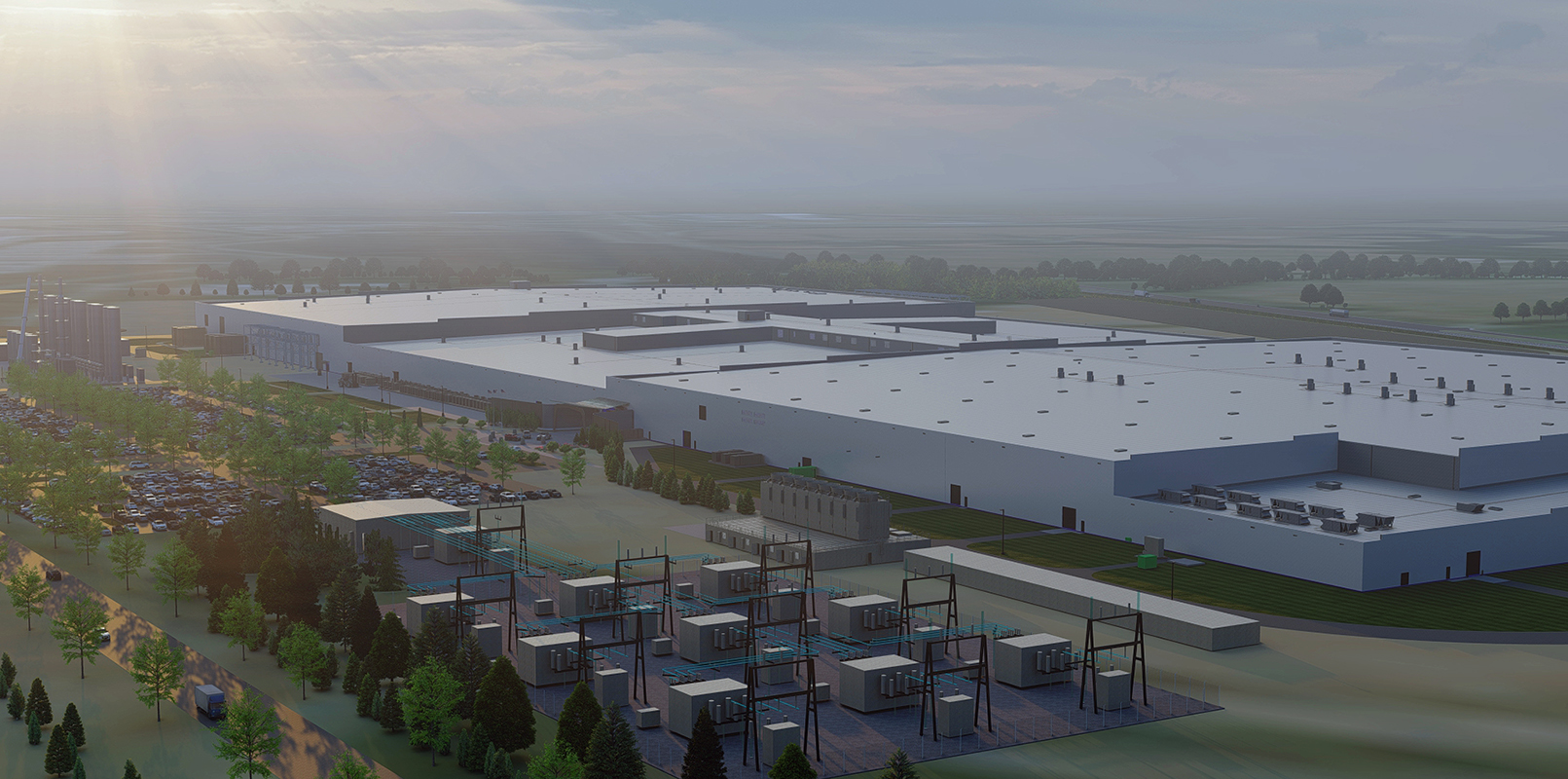

Ultium Cells Llc Spring Hill Tenn 800 6165ef4fea70d
