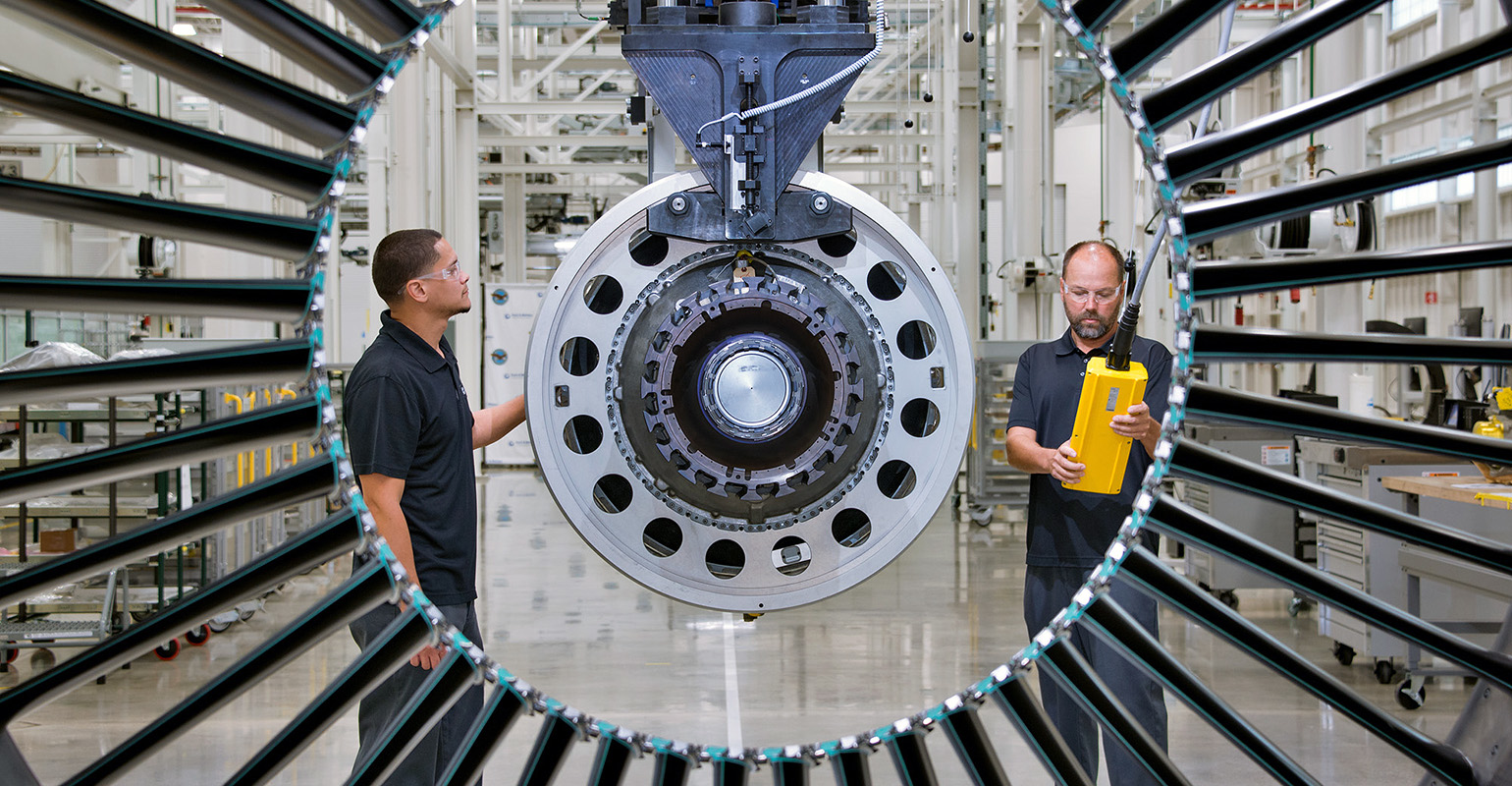

The Pratt & Whitney Geared Turbofan™ PW1100G-JM engine at the West Palm Beach Engine Center in Florida.
