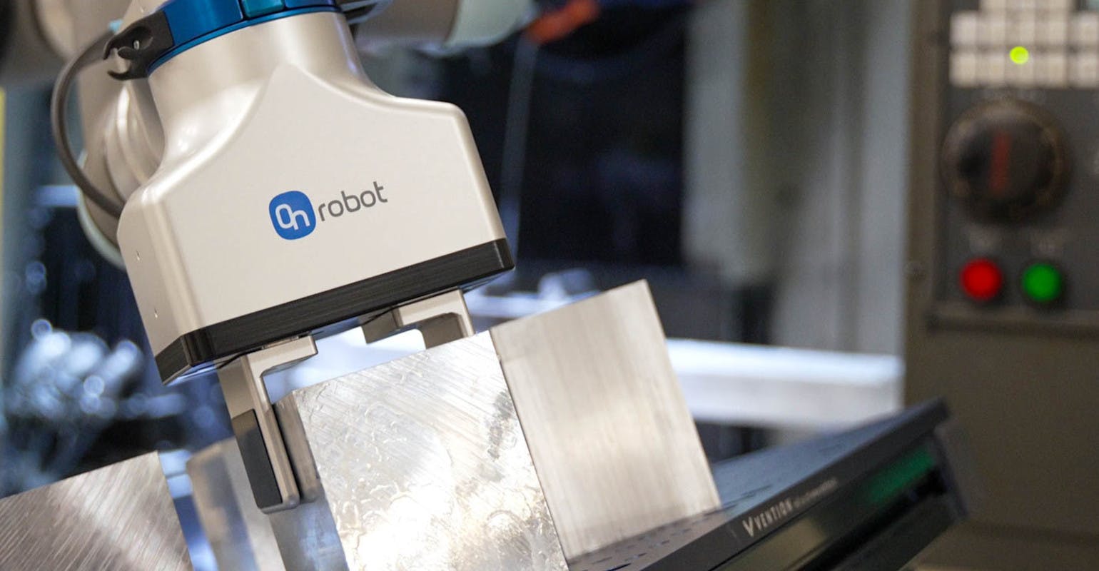

The new 2FG14 doubles the payload and gripping force of OnRobot’s 2FG7 gripper while also providing 30% more total stroke. It is a lightweight parallel-finger gripper with a payload of 14 kg (30.8 lbs.) – effective, for example, in CNC machine tending involving handling of heavy metal workpieces – with a new base design for work in places where workpieces are frequently exposed to oils or cutting fluids.

OnRobot’s 2FG14 doubles the payload and gripping force of the 2FG7 gripper while also providing 30% more total stroke, the 2FG14 is a lightweight parallel finger gripper with a payload of 14 kg (30.8 lbs.) The gripper performs well, for example, in CNC machine-tending applications that involve handling heavy metal workpieces with a new base design for challenging work environments where workpieces are frequently exposed to oils or cutting fluids.
