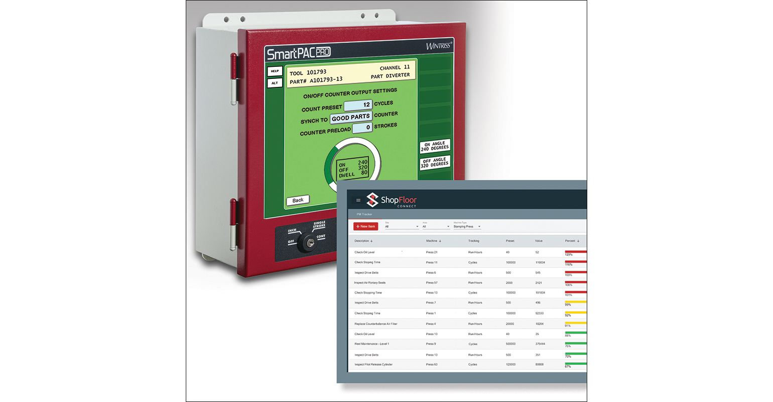

SmartPAC PRO (left) featuring new ProCamPAC PRO advanced Programmable Limit Switch and ShopFloorConnect (right) featuring the new PM Tracker for machine preventative maintenance tracking.

The new functionality in SmartPAC PRO and ShopFloorConnect collects downtime and production efficiency data from every machine, with data displayed in real-time, delivering detailed OEE reports in a variety of formats.
WINTRISS CONTROLS GROUP will demonstrate new features in its ShopFloorConnect® OEE and data collection software at IMTS 2022 – booth 135073 – as well as its SmartPAC PRO press automation controller. For a connection to a smarter factory, including when remote monitoring is required, the new functionality in SmartPAC PRO and ShopFloorConnect gives machine shops, metal formers, and fabricators efficient and easy-to-use tools.
Advanced ShopFloorConnect® OEE and Data Collection software collects downtime and production efficiency data from every machine, ranging from CNC machine tools to presses, fabricating machines and more, in all areas of discrete manufacturing. Data is displayed in real-time, and indispensable manufacturing reports are produced, including detailed OEE reports in a variety of formats.
A highlight will be the new ShopFloorConnect PM Tracker, which helps users to track important machine preventative maintenance factors by run-hours or machine cycles, issues targeted alerts when an item requires PM, and tracks the maintenance work history for all machines.
ShopFloorConnect 6.0 also features a new, universal Interactive Application Program Interface (API) that offers quick set-up for two-way data sharing with any ERP or MES software.
Also, Wintriss reports it has developed ProCamPAC PRO, an advanced programmable limit switch (PLS) for its flagship SmartPAC PRO press automation controller. This new PLS includes counter-driven outputs that operate only on specified strokes for precise control of gagging operations, new asymmetrical toggle outputs for controlling complex configurable tooling, and additional timed outputs for even greater versatility.
IMTS visitors also will see new, Advanced DiProPAC available on the SmartPAC PRO press automation controller, multiple new capabilities for greater die protection for presses. Highlights include a new customizable green sensor type called Green Flex that combines all the elements of the other Green sensor types. This cyclic sensor can monitor intermittent events such as gagging operations, and also has a function that allows for the precise monitoring of events that need to occur multiple times per press cycle.
In addition, Wintriss has expanded the static sensor-monitoring capabilities in DiProPAC with auto-reset, programmable bypass angles, and minimum actuation time settings.
