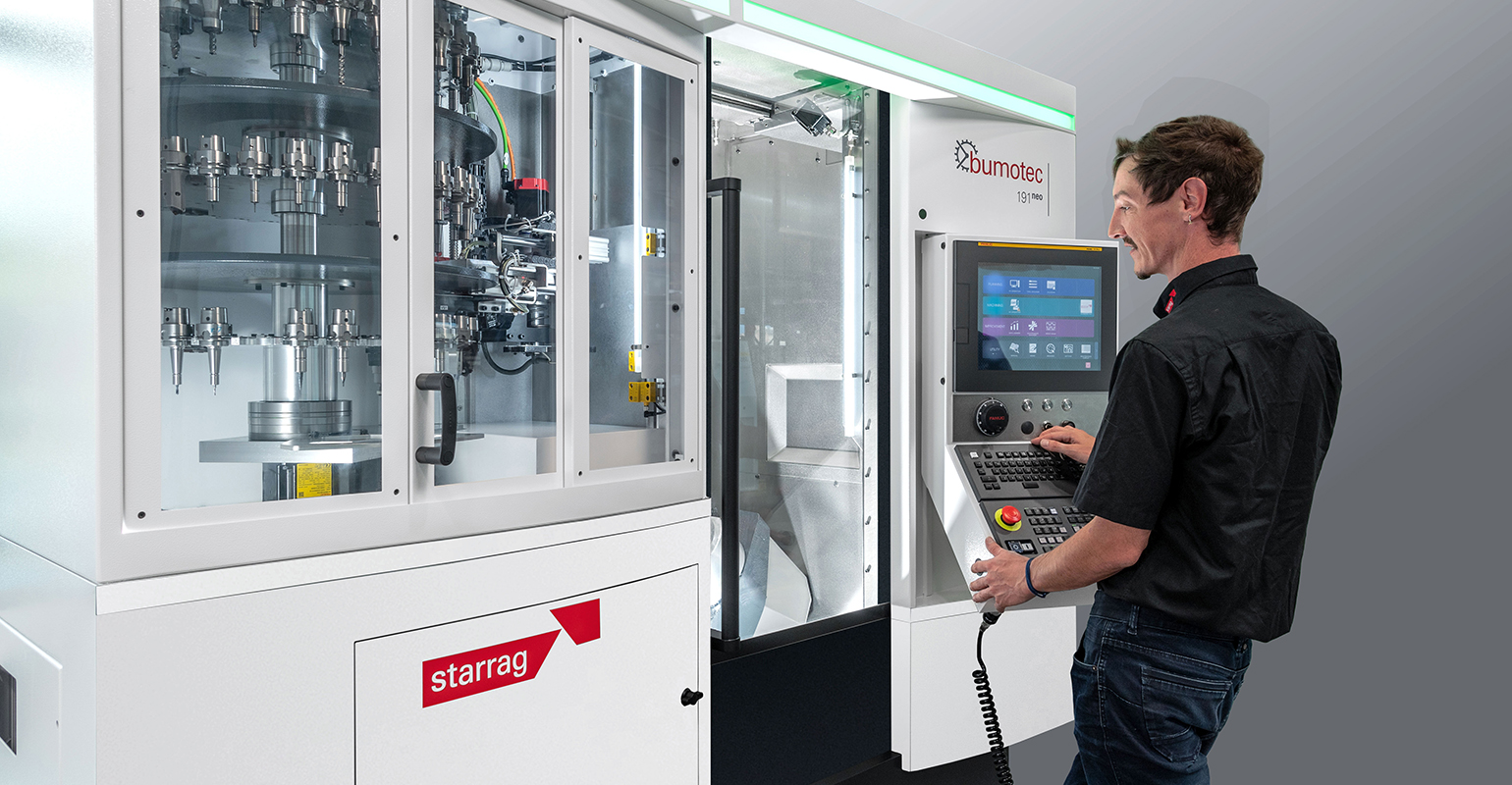

The Bumotec 191neo offers high visibility to different machine zones, with touch-display MMI that simplifies monitoring, programming, and real-time production tracking.
STARRAG GROUP has developed a new version of its Bumotec 191 mill/turn machining center – the Bumotec 191neo – building on its reliability, performance, and modularity and housing the operation in an ergonomic enclosure.
The Bumotec 191neo presents a large area of windows and perfectly positioned access doors, for high visibility of the different zones within the machine, and accessibility for all operators.
The touch-display man-machine interface, developed from a Windows-based PC application, can be used to swipe easily between screens. Among other functions, it can be used to monitor the progress of current machining operations, configure the programming, or track production in real time.
